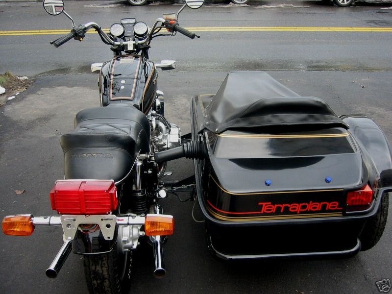

I found a good picture of the rear of the Terraplane. The brake light / tail light looks as though a rectangular deep lens might be modified to fit.
Measure your old lens (if you have one) and compare it with lenses available from Napa, Autozone, Pep Boys, O'Riellys or the auto parts house of your choosing. if you find one that is close in dimension then you might be able to re-conture the back edge to match your housing. In fact that lens might very well be a bike tail light from a bike produced when that car was built.
The Terraplane was only produced between 79 and 82 so that might be a good place to start. If it's a bike tail light then start with the big names like Honda, Kawasaki, Suzuki or Yamaha. Since Vetter produced the Hondaline fairing and the Kawasaki Vetter Windjammer start with those.
Vetter collapsed in 83 with a bankruptcy so there's certainly no reason to search later than that and the Terraplane was not being produced when the company was still under Craig Vetter so that rules out anything before 79 or probably 80. Look at the picture of the rear of the car. The lens is secured by three screws through the outside of the lens. Watch for that pattern on the bikes you look at. I'd guess that the lens was an off the shelf bike part from between those dates.
