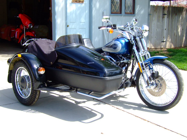

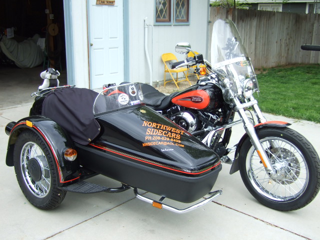

I replaced the stock windshield on my Velorex 562 with one from Gustafsson Plastics Inc. I ordered an 8" model specifally for the Velorex 562 and it came with no mounting holes drilled in it.

I've found the best way to drill the windshields is with a 3/32" bit using a reversable drill in reverse rotation. Sometimes a bit will catch and crack the plastic used in normal rotation.
For a 6" to 8" shield 1/8" Lexan works just fine and is much cheaper. We've used it for years. I cut it with a jigsaw with wood blade and cover the top edge with chrome door edge molding.

They had drill bits for sale along with their windshields, so I ordered one. Got the holes drilled with no problem and the unit looks good. I'LL take some pics and post them.
