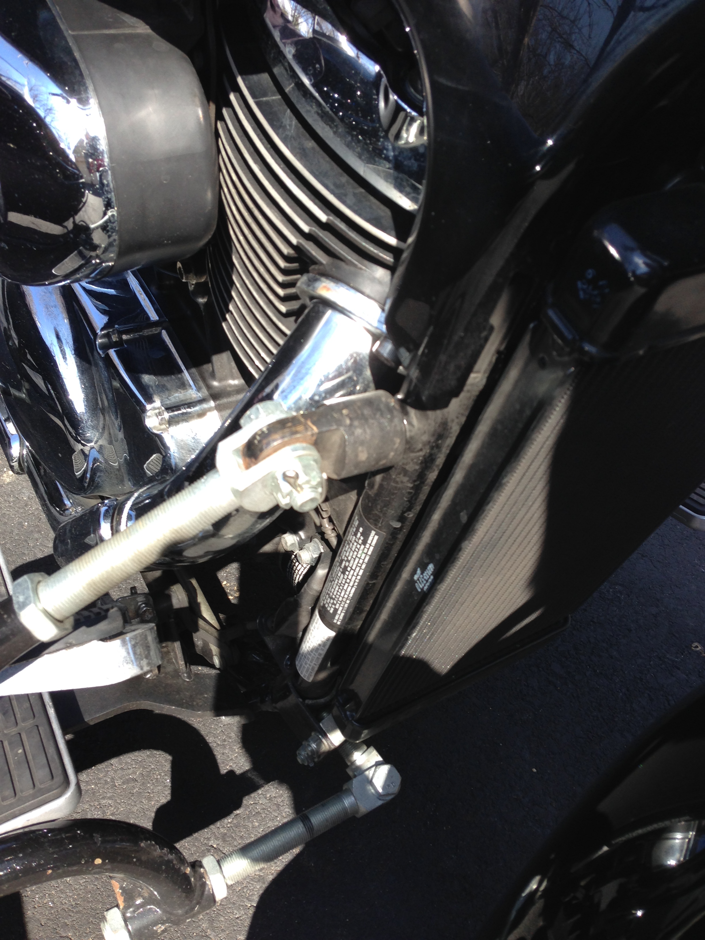

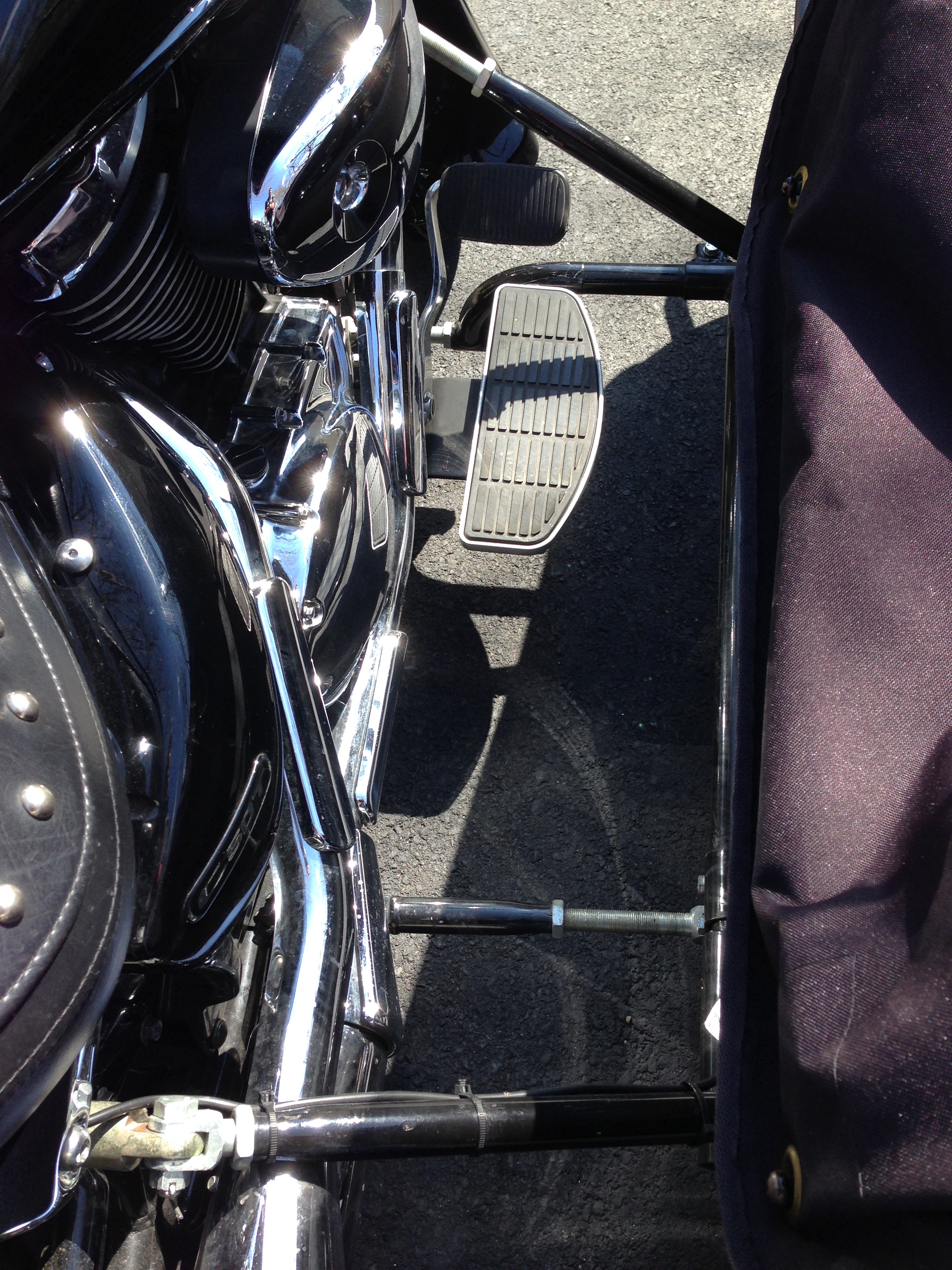

Well, I got my bike out of storage today. Man, the Wx in MD area has been terrible; rain AND snow last weekend but it felt good to take a ride today.
I have the pictures of the mount on my C50 to my Velorex 562 if anyone else is interested.
Happy Spring time riding to all! Keep the rubber on the pavement.
TomM
Edited to add 2 pix of mounts. Email me @tgmeyer@gmail.com for more pix.

Hey Tom , I have a question. I have a Velorex on my Sporty and it has the sidecar wheel lead at its maximum recomended distance now. As I look at your pictures ti looks like the sidecar wheeel is much farther forward than mine is. Do you know how far it is leading the rear wheel of the bike? is it hard to turn or scrub/chatter the sidecar tire wehn turning?
