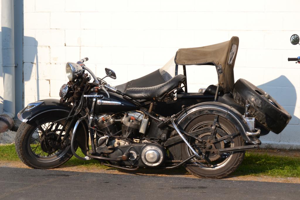

Does anyone here have a '65 Pan or later shovel with a sidecar? My '65 has the rear crash bars off and a solo seat. I have the bars and they don't seem to interfere with anything held up in place although it is a close fit on the sidecar side. I'm wondering if they clash with the car once you get rolling? Seems like I saw another one in a pic also without the rear bars. I also want to change the solo seat to a buddy seat since I already have several that match the black/white scheme. Is it customary to not have a buddy seat with a hack? Again going only on pictures, all seem to only have solos. I'm wondering if there is a reason for that? lololol... I'm already getting a hard time from my pan amigos for having the sidecar in the first place... saying I'm creating a "scoot-around." I expect you guys to back me up in the parking lot when I take them to task for that..... lololol.... - AZP

azpaul50 - 3/20/2014 3:51 PM Does anyone here have a '65 Pan or later shovel with a sidecar? My '65 has the rear crash bars off and a solo seat. I have the bars and they don't seem to interfere with anything held up in place although it is a close fit on the sidecar side. I'm wondering if they clash with the car once you get rolling? Seems like I saw another one in a pic also without the rear bars. I also want to change the solo seat to a buddy seat since I already have several that match the black/white scheme. Is it customary to not have a buddy seat with a hack? Again going only on pictures, all seem to only have solos. I'm wondering if there is a reason for that? lololol... I'm already getting a hard time from my pan amigos for having the sidecar in the first place... saying I'm creating a "scoot-around." I expect you guys to back me up in the parking lot when I take them to task for that..... lololol.... - AZP
AZP,
People generally remove them for several reasons, the spacing between the bike and sidecar to the rear mounting is a bit close , passangers will sometimes step up and go in between the sidecar and bike using the sidecar frame to enter the sidecar there's more to hold on to with that route. The lighter therory removing extra weight to lighten the rig up, I have seen a couple of older rigs with their sidestand removed, not a good idea should the sidecar need to be removed in an emergency.
The solo seat vs the buddy seat to me that's a personal preference to the owners taste I have seen a fair amount of older rigs with buddy seats. Harley in the late teens 20's and very early 30's made a tandem seat that attached to the rear of the frame with a hand hold for the rear passanger on the bike these were made before the buddy seats, back in those days it was generally their only family transportation.
Like I mentioned to you in one of your earlier threads it's your bike, heck I would put the buddy seat on if only for the added comfort.

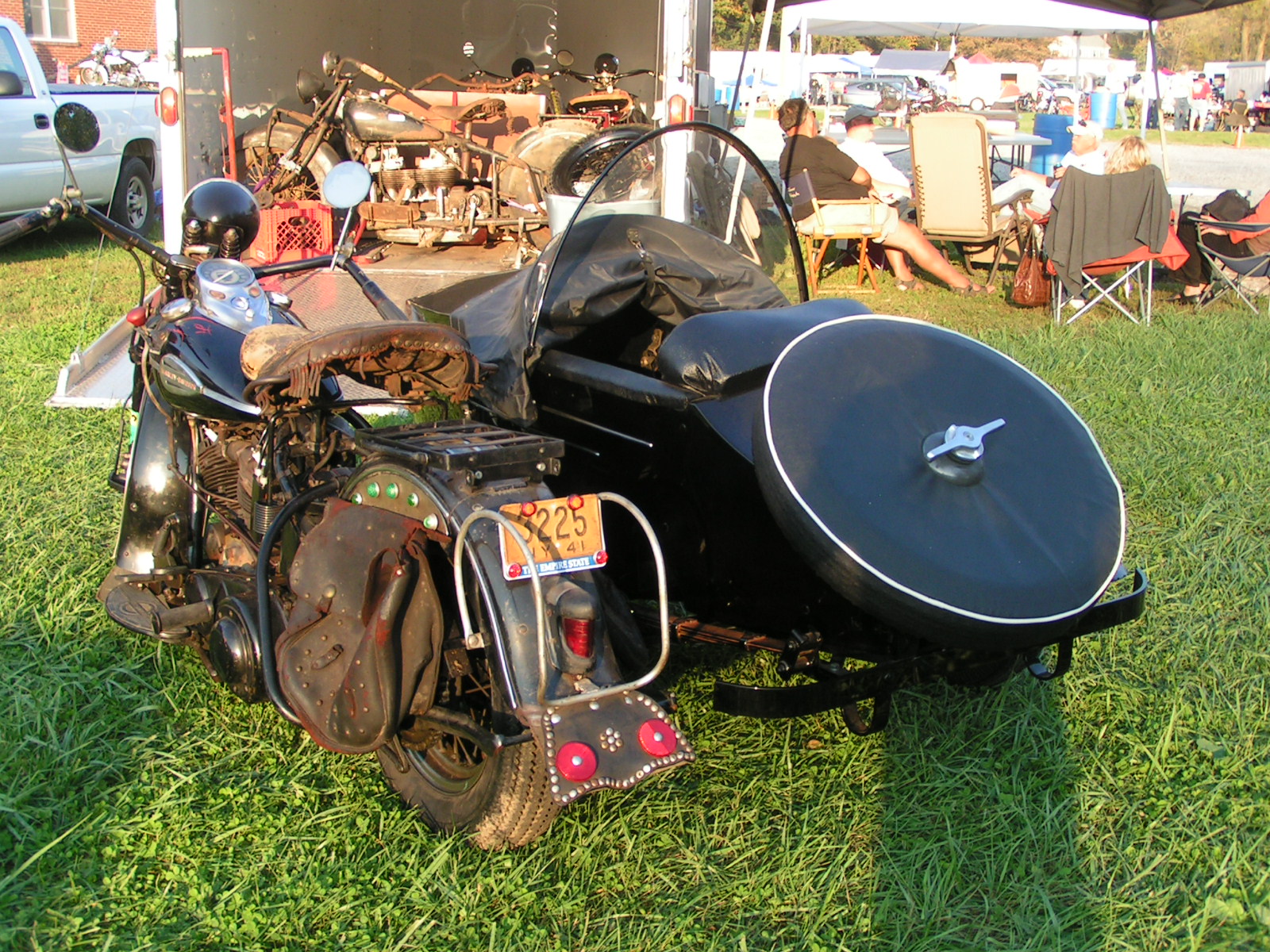

48 pan and a 41 flathead with buddy seat and rear crash bar
Posted : March 22, 2014 1:28 am
Chuck, you move that bumper a little over and protect sidecar and bike at the same time.

Now I can understand why the one ore other would take it off as it would hit into the saddle boxes.
My rear bumper is much tighter and thought for to have a hold on to point when you have to get out of the mud...

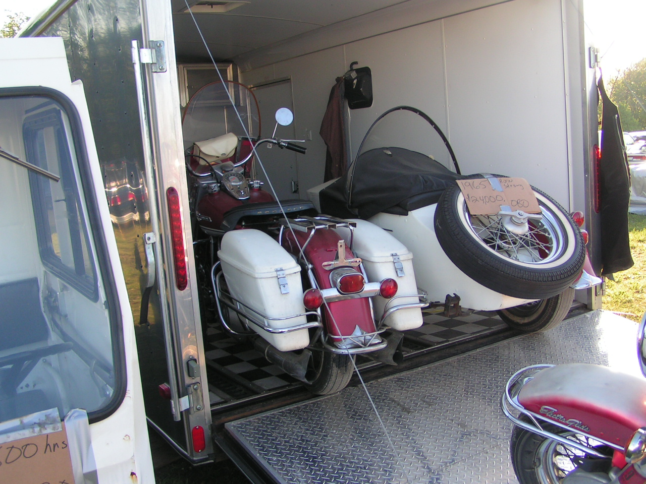

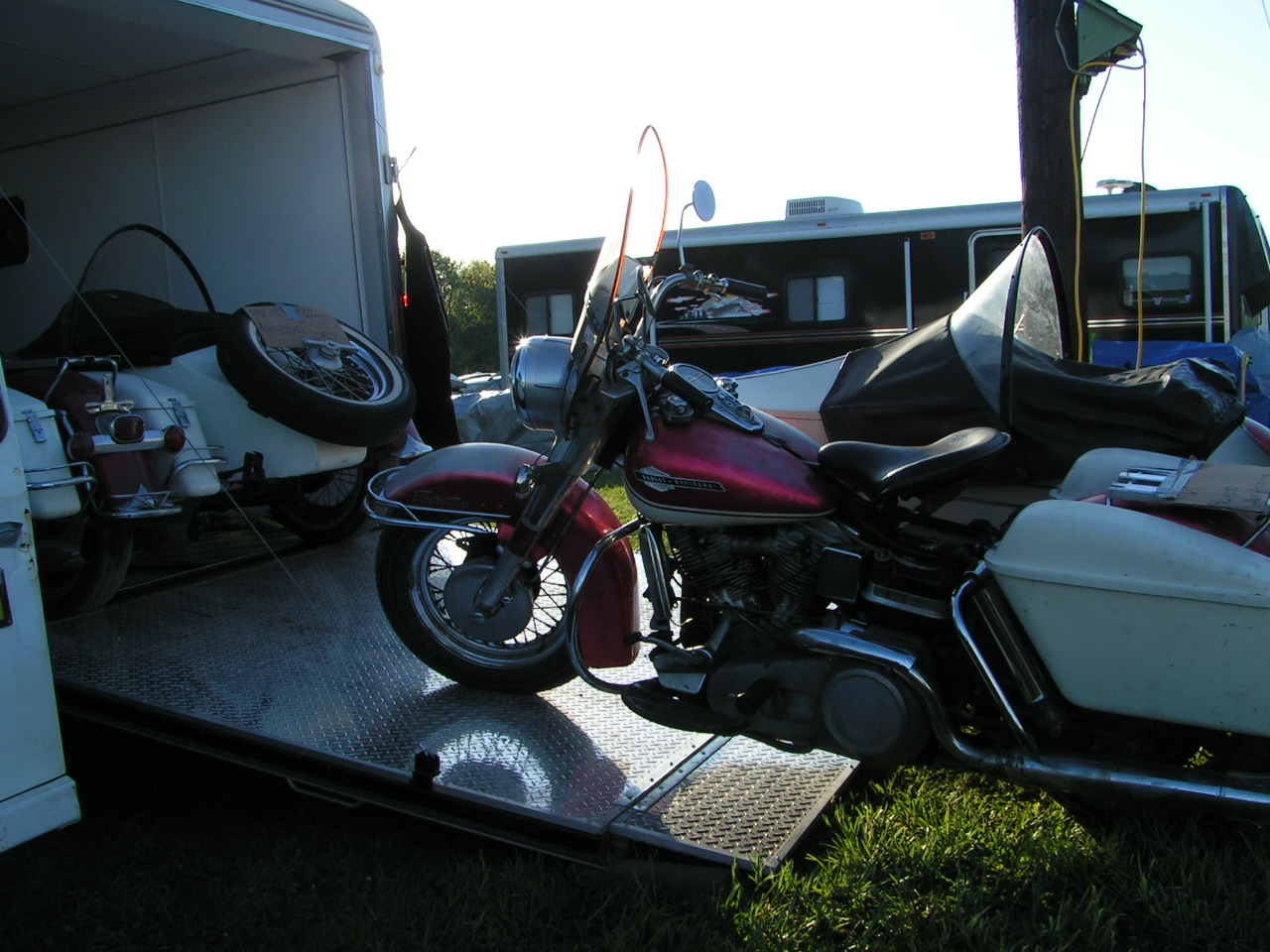

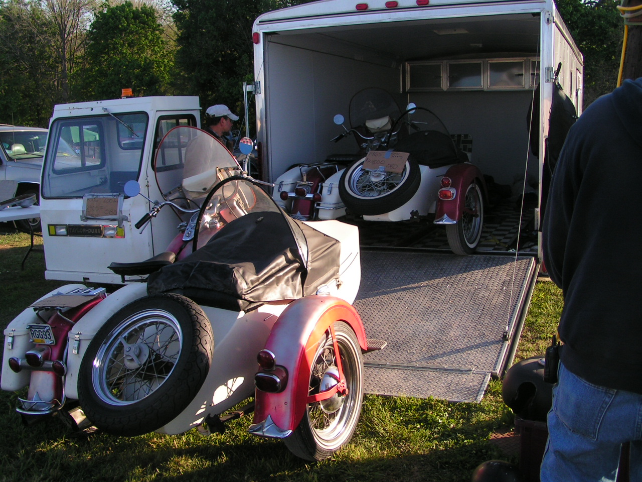

The photo with the two 65 panheads I was told belonged to two guys that were best friends and always rode together. Those were the last bikes each of them bought as they both got older they purchased new 65 motorcycles with sidecars. The first guy passed away and a few years later the current owner bought it several years later the second guy passed away and the guy bought the second rig sometime in the 70's. the current owner has had them since the 70's and brought them a couple years back offering to sell them for $24,000 each all original paint and accessories that each of the original owners had put on their bikes. Space was tight between the bike and sidecar with the saddle bags and crash bar but I saw no evidence of anything hitting or being touched up.
Now the last two pictures are rigid frame bikes but both have buddy seats and rear crash bars AND if you look the panhead has the sporty "Hollywood" handle bars but has the comfort of a top for his passenger.
The Flathead in the last picture is another original paint bike the rear hoops are more for period customizing looks........now a day I think it's called Bling?

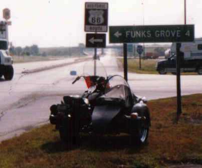

Now the pic. below is my 72 FLH/65 HD sidecar rig in Illinois, heading home to New York from Joyce Canfields National Sidecar Rally in St' Joseph Mo. in 1998

I just can't convey how helpful these pics are. I'm excited about the sidecar all over again! I have more confidence in my recent decisions both about the hack and bike. Just so happens I got a new spare tire cover exactly like the one in the flathead pic and the accessories on the '65 are exactly as I have or want. I have a complete set of correct white rubbers ready to install all the way around and white windshield bag. Most are like I already have on my '63. One thing unresolved is the front lower fender trim cap. I can't see if either of the '65's had the chrome lower front fender "cap" with black highlight lines in the depressions. I have original '60, '63, '65 and '66 H-D accessory catalogs and can't find it listed. Meanwhile, Greg Fields's Panhead book shows them on all examples of '65's. I bought a repop and resorted to using 1/4" black pinstrip tape to fill in the depressions. I tried to paint them in using several methods and couldn't get the paint lines to look decent. Working from my Barco-lounger, it turned out great with the tape! I was wavering about a fender trim cap for the sidecar fender itself. I gotta have one now, especially after seeing the tail light is the same as mine. I even have an extra RH-55 (plastic)lens to install on the hack's taillight. I had a glass one and broke it by accident one day. That would have paid for a lot of stuff today. Got better pics of your '72/'65?? Gimme, gimme, gimmee! Now... just for guys... if Blondie sees that complete cover (overhead) canvas like the '48 rig, she'll want one, having the biggest hair in Arizona. There's no place to get one, correct??!! CORRECT!!??? Get it!? Uzzz guys are great! - AZP uhhhh.... looked up "sledge riding". I've never lived in snow country and just lived in snow while in the field in Korea and Japan including a winter Mt. Fuji trek. I have the stamped walking stick to prove it! How does a "sledge ride" involve a sidecar? Sledge riding? huh? You gotta take the car off, right?

Looking at the first pic. of the pans I do not see a lower trim piece on the fender, I would assume that the second rig in the trailer was the same.
