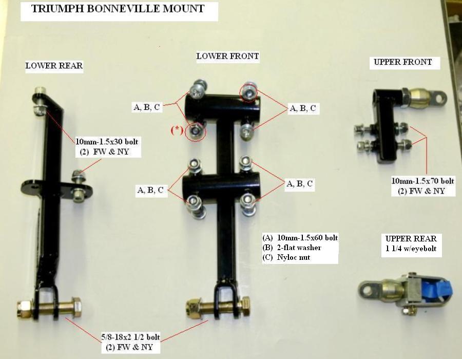

Is your rig already mounted and only needs adjust, or it's in parts and some things must be fabricated? In first case you can try to do it yourself or with small help from neighboh. It's your car on the photo? This long threaded shaft in front lower mount doesn't look good?

Hey thanks for the quick reply. Yes, the bike shop down here did not follow Bob's install instructions. The struts need to be rearranged and sidecar will be closer to bike.

Give us more photos. If it's properly installed (good parts in good points), it needs only some adjustments that you probably can make within an hour, so you will not need towing your rig to someone who can adjust a rig. It's somewhat simple if done with patience.

Jay, doesn't this lower front mount look odd to you? You have seen many better or worse installs in your life, so you can "feel" if it has chance to be proper mount.
Posted : June 3, 2013 4:45 am
All I can see is the part coming from the sidecar. This is the way Velorex does things. The only adjustment for wheel lead is where you place the "universal" frame clamp which is why almost every Velorex sidecar we see has the wheel lead wrong. Also it looks like the brake has not been hooked up which I think is just plain stupid to have a brake and not have it hooked up.

I'm thinking of this long screw from bike to front j-connector, if it isn't too thin. Velorexes I saw, had original screw much thicker and some shorter, not 2-3 inches between bike and connector (universal versions) or specific Jawa j-connector that reaches bike's frame and is mounted just to frame by its "eyes" with almost vertical screw.
Posted : June 3, 2013 5:02 am
We make a lower rear mount that bolts to both sides of the frame. Not sure if this will help or not.

Often the problem is that the "Velorex" universal mounts seldom work proper. Velorex will pretty much let any one be a dealer as far as I can tell. I have had customers when they found out that there was not a dealer in the area being asked if they wanted to become the dealer.
Attached you will find out basic installation instructions.
