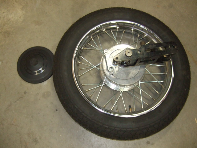

Received some Velorex parts in the mail today from Lonnie and they are top notch as he described them.
Now is time for the mock up and install...
