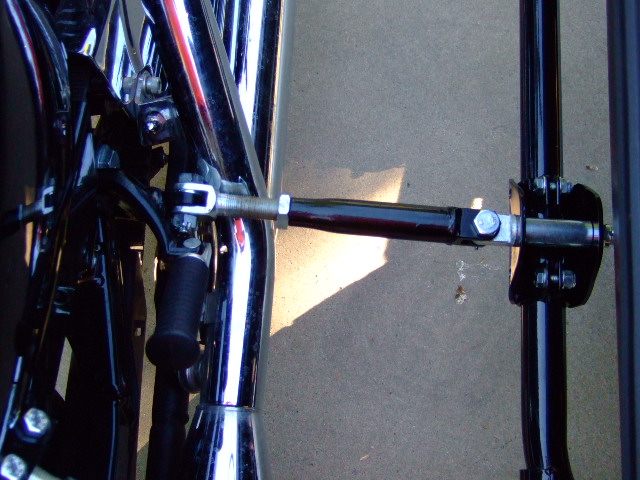

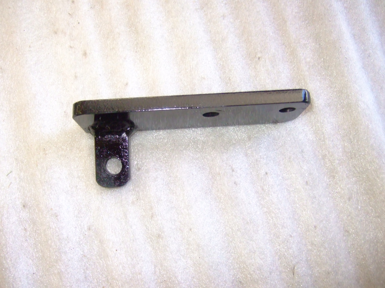

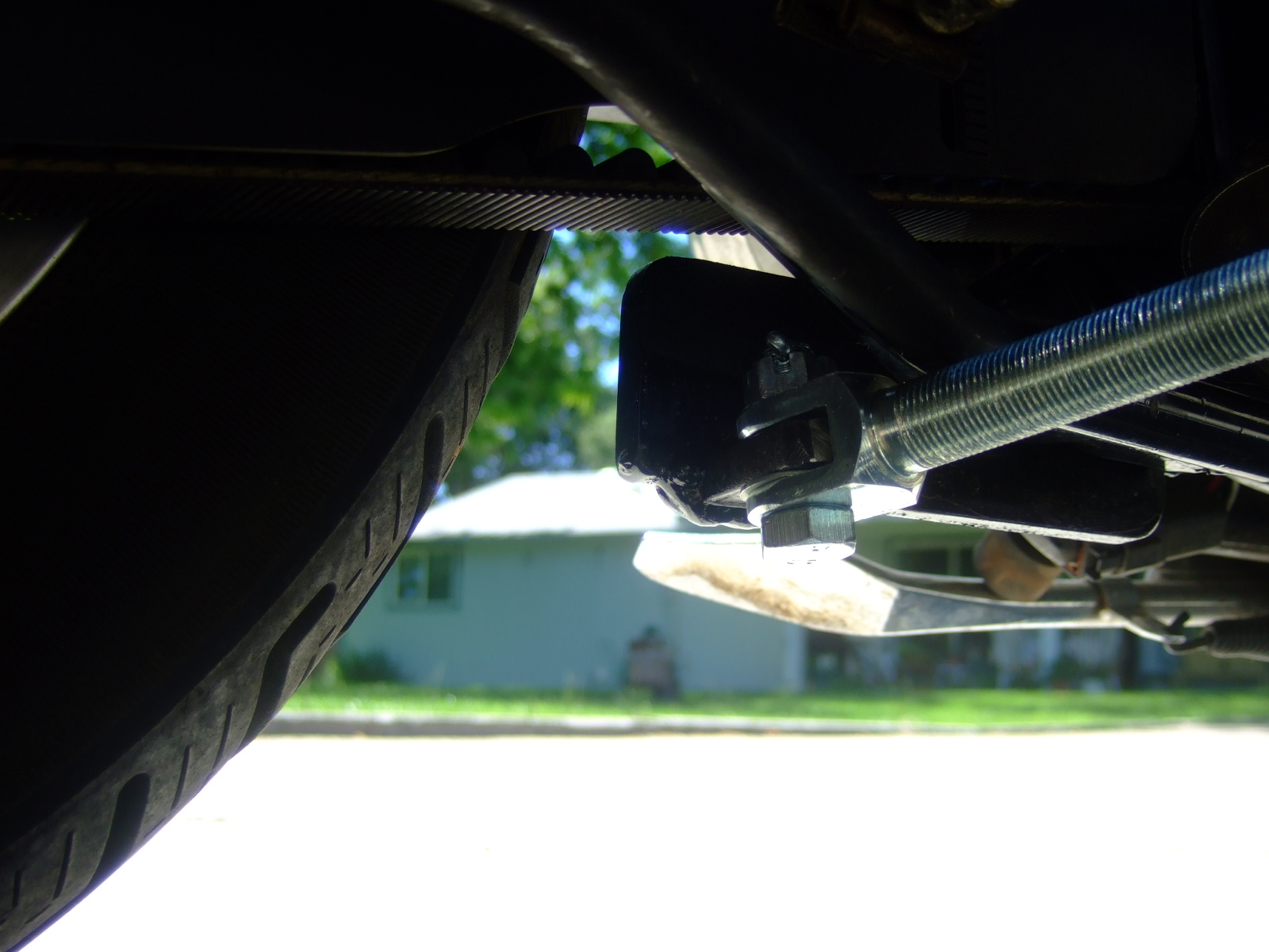

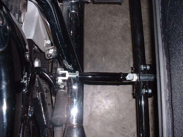

Having mounted hundreds of Velorex sidecars to both early and late Harley Sportsters in the past decades, I've found that the rear lower mount is the cause of most problems. The other three have proven quite adequate.
Most Velorex cars are mounted as per the instructions in the Owners Handbook on page 6, figure 5, which shows the (over engineered) rear sliding clamp mounted with the strut in an angular position. This allows the clamp to slip, or rotate easily, under stress causing a loss of alignment. Mounting the strut as shown in the attachment will keep it from slipping in most cases. A spot weld or two will eliminate slipping altogether.
A fabricated lower rear bracket as shown, will allow the sidecar to be mounted further back in relation to the bike.
A full subframe mounting system that employs both sides of the frame to reduce stress is naturally superior.

The bracket shown in the pictures just bolts on to the subframe which runs back to the exhaust? Any idea on the cost of such bracket? I could probably fabricate one myself, I have a welder, drill press, etc.

That bracket is a self made part and looks preety simple , my plan is to make one similar to that and maybe a little over engineered this winter. The threaded fasteners on my most all had nylon nuts or castle nuts with cotter pins.

I have a velorex frame, and I'm curious as to how important is it for the rear lower mount to be 90 degrees, or perpendicular, to the bike? To do so, I have to mount it at the mid-point of the sidecar frame, and it seems to create a fulcrum or pivot point. The only way to move the attachment point back further, is to mount the attachment to the bike up and towards the back of the bike. The whole rig seems much more stable this way, but I'm not sure if that changes the stress points in an unsafe manner.
Thanks in advance for the help.
Dave
Posted : January 14, 2015 6:50 pm
The reason for the 90 degree angle is for a neutral standoff point for the sidecar, to maintain the position of the sidecar to the bike and keeping the toe-in static.
The rearmost strut mount position can also be used for this function allowing a few more inches more rearward attachment.
Posted : January 15, 2015 7:59 am
Thanks, Hack'n.
So, as long as one of the rear attachment points (either the lower mount or the strut) is perpendicular to the bike, I should be OK.
Posted : January 15, 2015 9:25 am

Dave your problem is exactly what I have. The lower rear is almoxt centered on the sidecar frame. the picture i putup of the metal plate is an extension to move the mount back farther. The 90* is not exactly needed but the bolt in the mount to strut attachement should be vertical to help prevent the clamp on the sidecar frame from rolling or slipping.

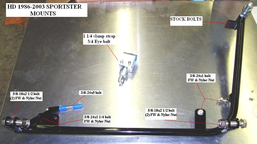

Here is what our sub frame looks like for the 1986 to 2003 Sportster, as you will see the lower mounts are equal distance from the ground and the lower rear is quite a bit further aft then the main frame of the bike.
