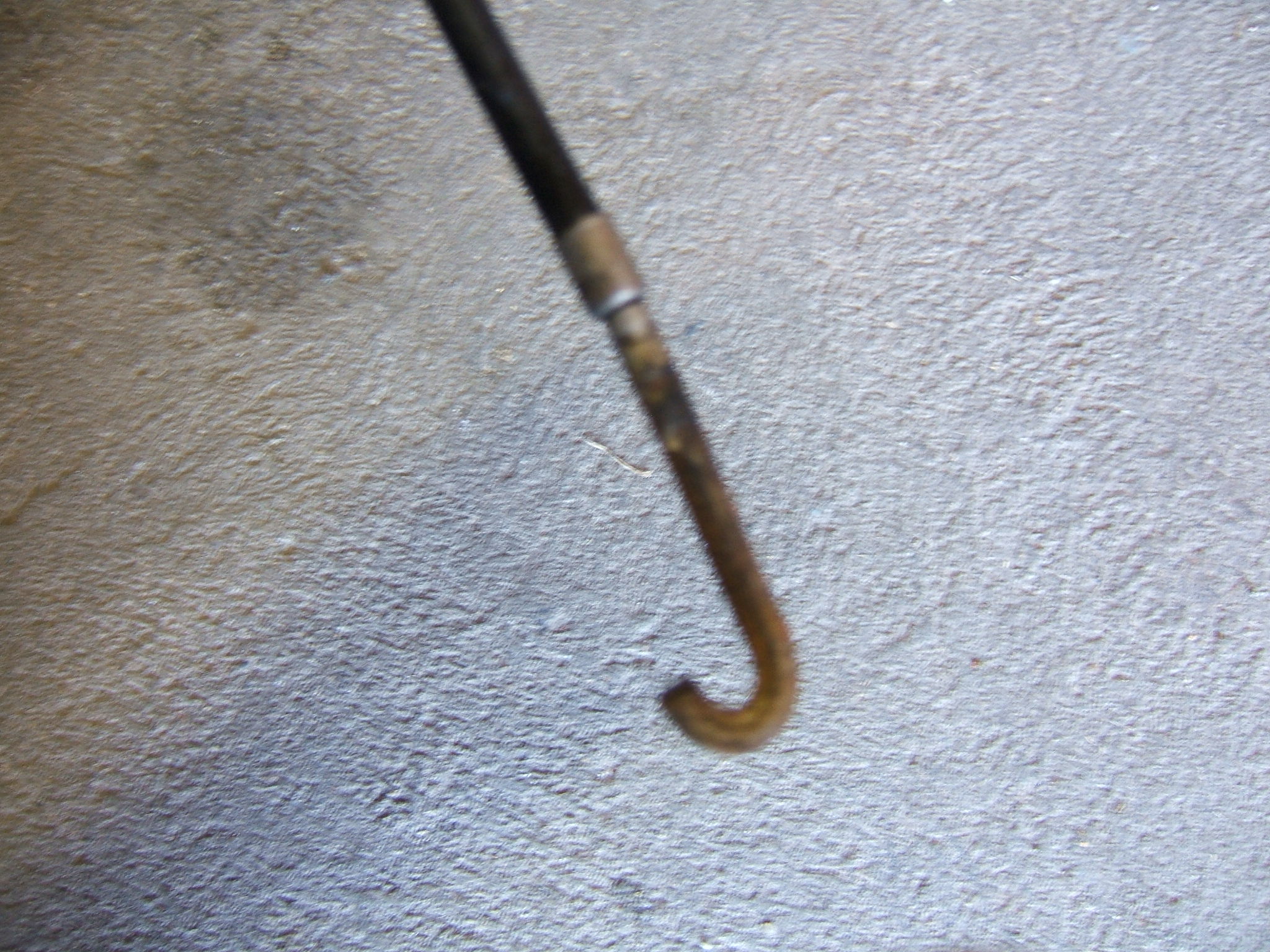

Tom,
Attached are a couple of pics showing the hook on the end of the brake cable, and the point on the brake shaft where I had the cars cable connected. Pencil tip shows the post on the side of the bikes brake shaft, located under the foot peg. I just slip the hook over the post and use a clamp on the cable and it stays connected.
Had to wait until I removed the car to get the pics.
Going to sell the car. Went for a short trip today and when we returned my wife could hardly get out of the car. Arthritis, degenerative disk, and who knows what else.
Posted : March 7, 2014 1:19 pm
