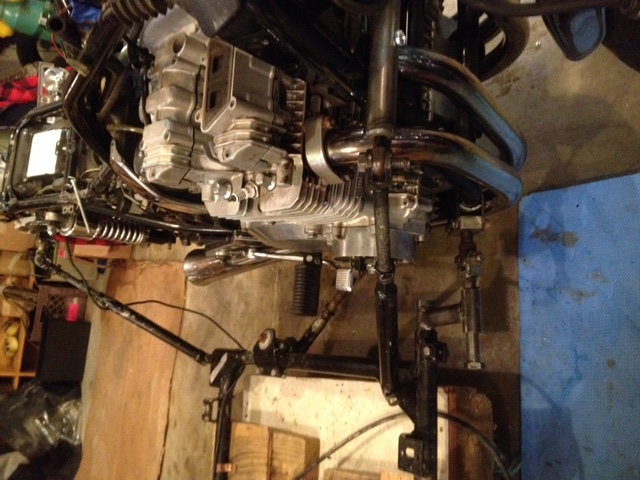

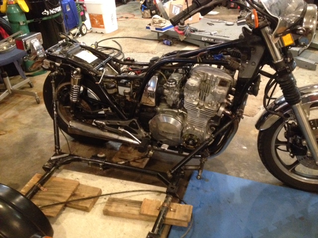

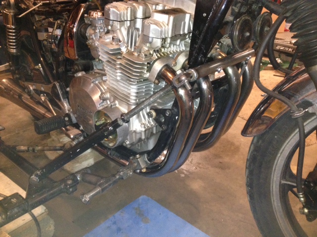

My first rig - I traded my way in to this project I tried to get good equipment and think I succeeded I have read the velorex installation manual and I read Hals stuff as well as the german stuff. Heres what I have.
43 track
9.5 lead
34 toe
12 inch of lean out
She's a narrow one. This bike has 4.75 trail. I am working on the starter clutch and adjusting the valves on the bike waiting for parts so what you see here is my first attempt. I'd like some constructive criticism here.
I can make changes to this if you have some ideas......

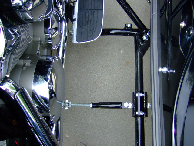

The rear lower mount should be mounted at a 90 degree angle from the bike. Like this VTX 1300.
I often lengthen the upper struts so there isn't so much threaded bolt. Yours seems almost to the limit.
Recommendation is 2" of threads still into the strut but that leaves 8" of threads exposed.

Hackn. At 90 degrees on mine I'm 14 inches back from the front. Any issues with that beeing too far foward

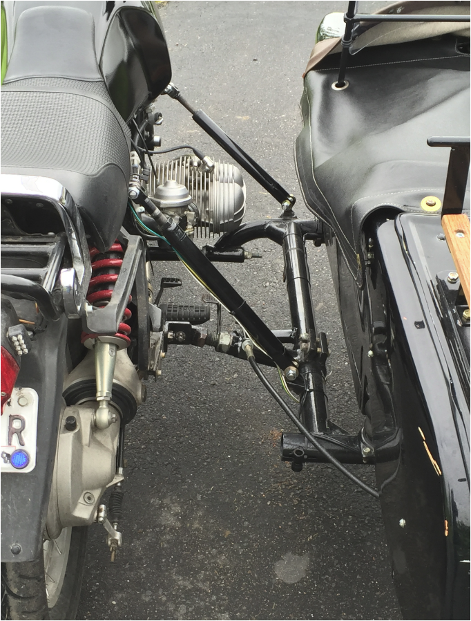

I had about the same problem with a near similar sidecarframe: The frame was not long enough to set it in a sane way beside the bike.
I made the frame longer to have a chance with the front joins

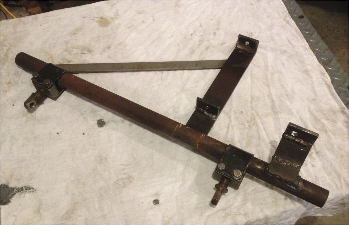

Have a look at the clamps I welded to the sidecarframe underneeth the left tube.
This is the final condition of the frame after painting
I always try to mount the lower rear part of the subframe to where the mainstand originally belongs and then build a support against twisting wich is bolted to the footrest mount.
I would recommend to set the two diagonal struts in a way that they lead into the same direction. (90° to the sidecar or both to the front) Otherwise it´s likely that your rig isn´t rigid enough.
It´s a good idea to have the two lower mounts in a distance of at least 20 inches.
In your country it seems to be totally negligible if you buy the stuff to build a rig or make it on your own. For me that´s a dream!!! Here you have to go through a technical examination with the new built rig and you can only pass that if you bought your gear
from a certified company or if you have a master´s certificate in motorcycle mechanics (wich is what I have)
So get a buddy with a mig welder and build a reasonable subframe to fit your bike. It´s done in two saturdays if you do it the first time. And it´s a great advantage for your rig.
By the way: The sidecar axle was changed to a 20mm diameter one due to the heavy bike and the discbrake.
I hope, you don´t think I´m a smart a$$. I just want to give you a suggestion how to do it yourself with a reasonable result.

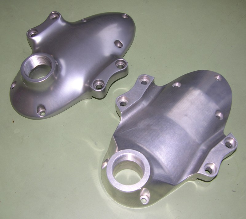

BTW Claus, nice mounting job, we make for your bike a new from billet ball joint mount for the telelever front end to lower the steering effort with the sidecar. I have attached a photo. On the left is the stock part, the right the part we make.

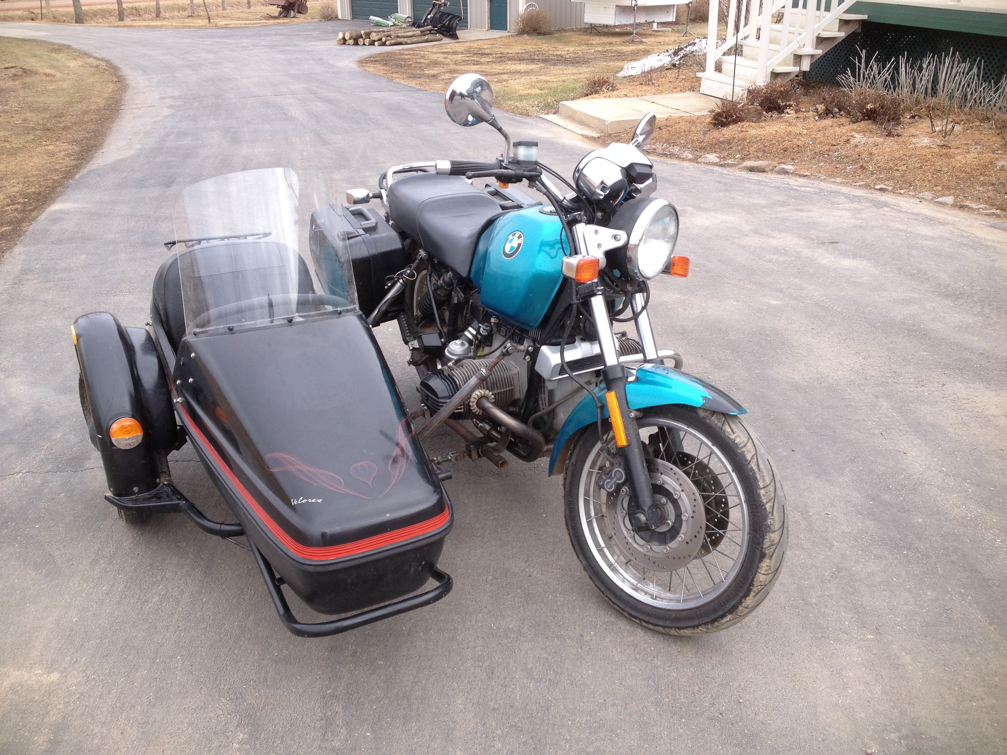

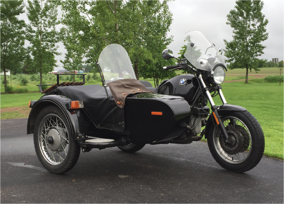

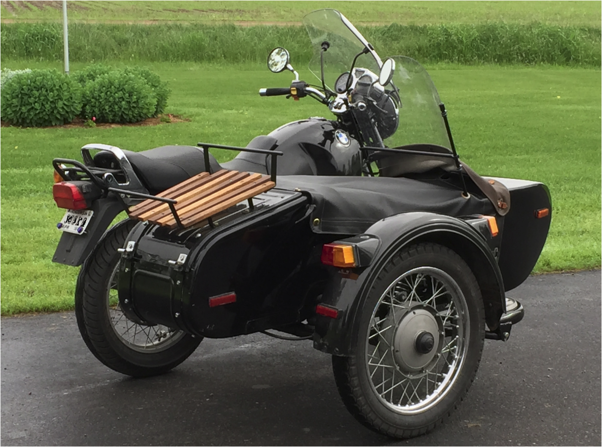

Thank you all for the guidance and direction with this project. The Kawasaki turned into a 1993 BMW R100R. Not the perfect tug but adequate for the car. The car went from a Velorex 562 to a Ural. Whew - got my money back on the car in less than 48 hours on Craiglist although I had to throw in a sportster mounting braket I got with the Ural car -
Im not done yet - are we ever done? Im riding out to to Sturgis and hopefully meet some of the folks that inspired me to make this first sidecar project a SAFE and reliable rig - best I could with the funds I have. So here are some pictures of my first rig that Im sure ill have years of service out of .
If you are looking at building a rig you cant get better information than what you will find here at USCA and the knowledge and advice will save you a lot of hours on a project that will take a lot of hours - so join us! And give me a shout any time. I have a tiny bit of knowledge to share and would be glad to chat.
