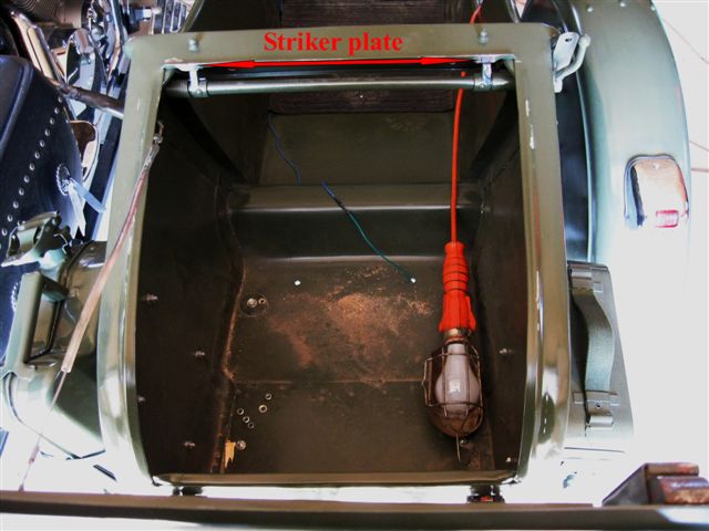

I have a CJ side car and am having problems with the trunk not latching on the right side.
This unit has slam locks on it and the left one latches ok but you really have to slam it to latch and is to tight in my opinion. The right one won't latch at all.

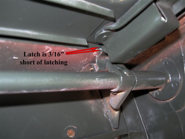

I took the seat out to see what was going on and the right latch is 3/16" from going under the striker.
The trunk opening measured diagonally from corner to corner varies by about a 1/4" but the trunk seems to line up fine.
The measurements from the floor of the side car to the striker plate are the same on both sides.
Is there a way to adjust these or should I try to find a adjustable latch and just replace them?

Drill out the rivets on the right latch, shim it out to match the left side and rivet or bolt it back together. You ma need a dab of touchup paint.

I did put a piece of rubber on the corner that was latching and for some reason the other side latched. Must have put a little twist on the trunk is all I can think of.

I have the exact same issue with my CJ trunk. There is too much play in the sliding mechanism and that is why it does not latch. i will try a shim between the mechanism first before drilling out the rivets to see if this works. Also, keep an eye on the rubber bushings up front. change the Chinese bolts and nuts before you have a problem. Oh, and watch out on the connections to the bike if they are Chinese,change them too!
