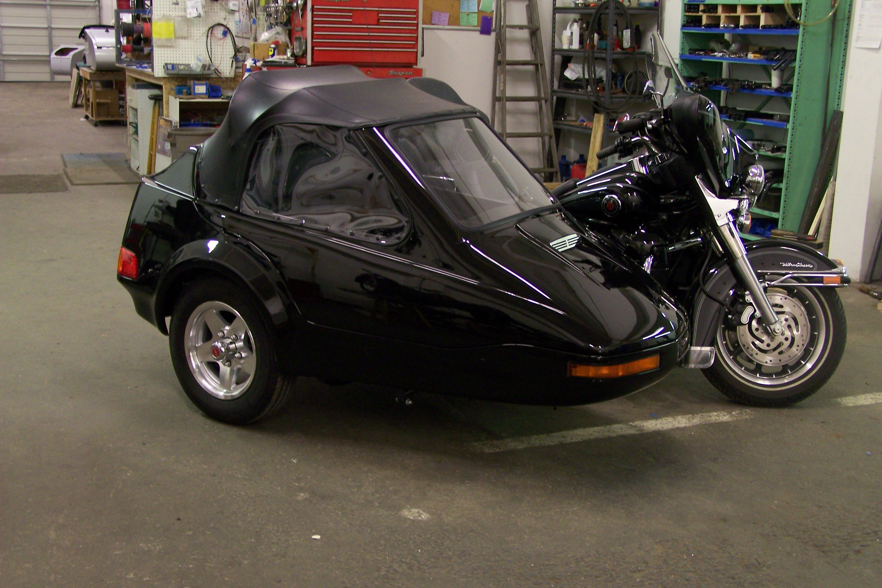

Just a little FYI stuff here. Everybody talks about how many degree's of rake different trees use. The key here is how much trail reduction results with the installation of the different trees. In a way the fork rake angles tell you which is less trail because the higher fork rake change also means less trail. Less trail is what makes the steering lighter. Had an employee once build a leading link that actually had negative trail. That test ride was exciting. LOL I find getting trail down around two inches is usually good for most although I have mine at one and a quarter inches. A first time rider with trail reduction as low as mine will usually take a while before they can keep it straight. I have been riding with it so long I don't even notice any more and a thousand mile day is not a problem.
Another thing is the use of fork extensions with these trees. They will work with or without just as well if aligned correctly. The two things that will be effected are that the trail is slightly different with and without extensions and also without you have a noticeable reduction in ground clearance.
The last thing I want to mention here is the use of a damper. On occasion I find a genuine need for a damper and will use one. Mostly I don't because if there is a problem playing with the alignment will usually fix it. Large companies like HD for example will always use one because it can cover up some alignment problems which makes it easier for the novice to align a sidecar good enough to work. It also keeps the liability issues down if there is a problem.
I'll try to post a picture of one I mounted today. Rides great one handed and no shake. Barry
