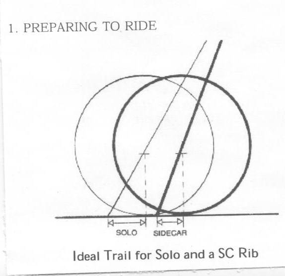

(@comet66)
Posts: 113
I guess what is confusing me is this diagram from Hal Kendall's "THE SIDECAR OPERATOR MANUAL 2003."
Does this not suggest lessening the trail from solo to sidecar? Bear with me I've not attached an image on this forum before.
