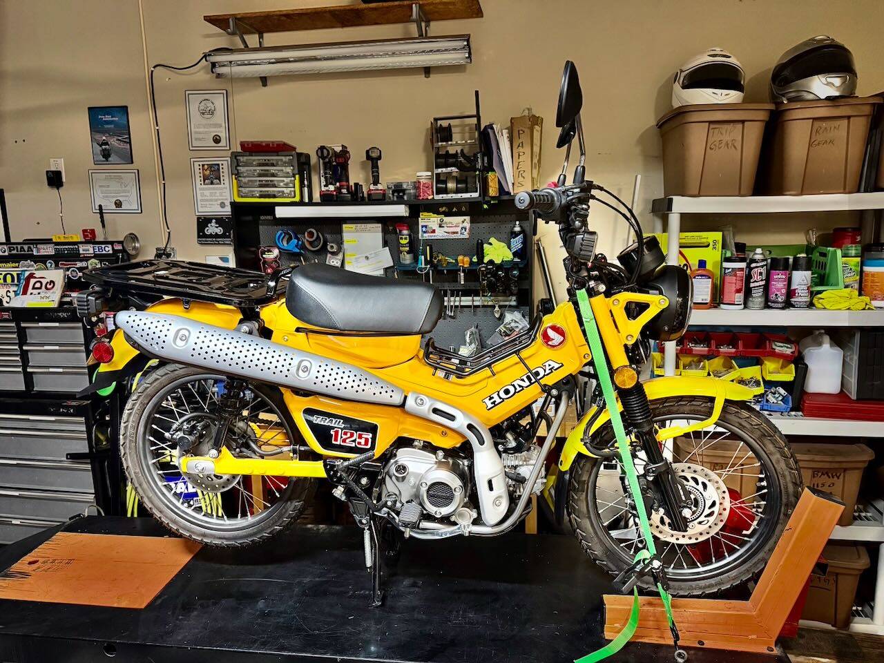

Ok guys, am turning to the group for ideas, suggestions, warnings and insight. Bought a very low mileage (showing only 38 miles) 2024 Honda Trail 125 to haul on the tail of an RV to use as a campgrounds scoot. But... I want to add a lightweight (probably aluminum) cargo sidecar to it.
My thoughts are:
1. Reduce countersprocket teeth from 14 to 13 for more torque
2. Raise handlebars and seat for my height
3. Add USB outlet for iPhone
4. The bike weights 260, need to keep total weight with sidecar to less than 325-335
5. Use a narrow bicycle type wheel or similar for sidecar to give more ground clearance and easier rolling.
6. No brake on sidecar
7. Locate mounting spots on bike for subframe and upper struts
8. Will be keeping speed to 30-35 mph, tops. No Alaska backroads planned for it.
9. Plan to keep a narrow wheel track, +/- 26-28" c2c
If you have already build a creature like this or have been planning a sidecar build for the Trail 125, would love to hear your thoughts, suggestions, problems encountered, solutions, etc.
What are your ideas ??????

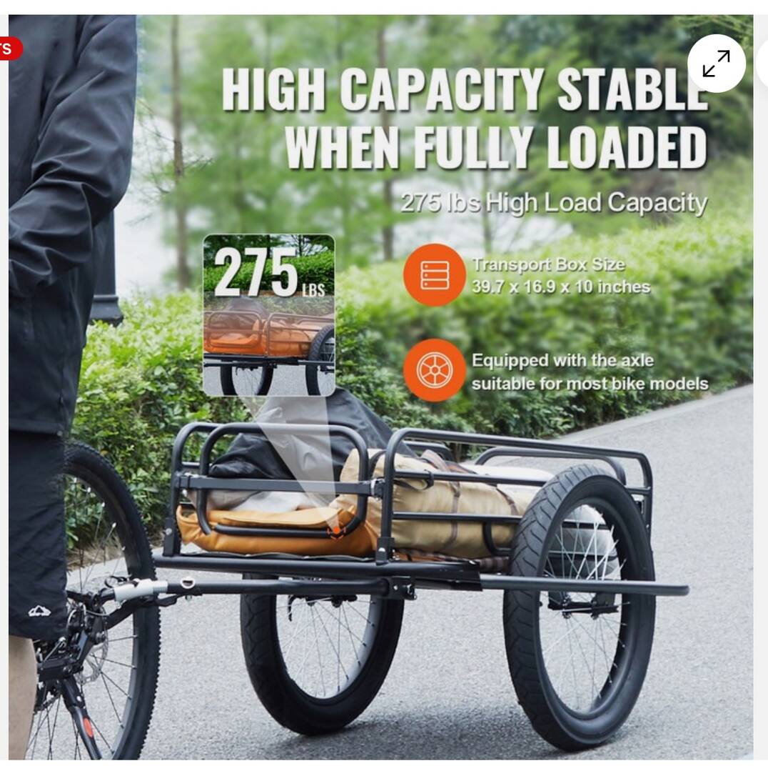

Was looking at bicycle trailers, found this one. Total weight is 40 lbs. Use just one 20" tall wheel, keep the other wheel as a Prince Harry.
Bicycle trailer
Also have an aluminum sturdy cargo basket that could be cut down to a smaller, narrower size., mount an full width axle, but how ro create a lightweight shock or rubber bushing for the axle.

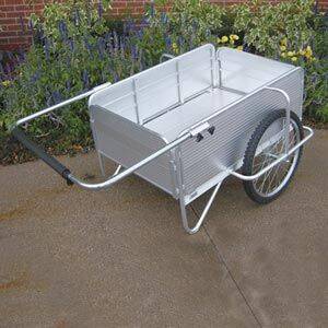

Just for an idea on the sidecar side of things:  https://www.farmtek.com/prod/109630.html?srsltid=AfmBOorRERN1VabaR1iEIciDjEBC6decXxoPFOJgK7ZWlKsqNyzk2UsiYak
Posted : February 17, 2026 9:44 am
2FLTC, Thane Lewis, CCjon and 1 people reacted
Posts: 1517
Posted by: @scott-h
Cool idea! 😎
Any thought to making it a "Leaner"?
Reason for the ask is much less stress on the sidecar and motorcycle, so everything can be kept on the light side.   Carefully crafted you could just fold the sidecar up to the bike to load on the back of the RV.
Scott, we all know that you are just giddy that Jan's new Honda Trail 125 is YELLOW, and not one of those Red or Green models.
basic_smile
Posted : February 17, 2026 10:56 am
sheath, Thane Lewis and CCjon reacted
Posts: 1517
Posted by: @scott-h
Actually, I have to say that Scott has touched on a brilliant idea. (it hurt me to say that, but he does have brilliant ideas now and then)

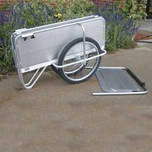

Jan @jan-2, what about towing a very lightweight FOLDABLE aluminum trailer behind your YELLOW Honda Trail 125, rather than making it a sidecar rig ?
This all aluminum FOLDING trailer would be ideal to tow behind your Trail 125, and still give you the maneuverability of a 2 wheeled bike, but the carrying capacity of a sidecar tub, yet can be folded up and placed next to the bike on the hitch carrier.
109630b
109630a
It would take a LOT less fabrication to make a trailer hitch for the back of the Trail 125, than it would to attach a sidecar to the bike.
AND....if you think about placement of a trailer hitch onto the back of the bike....LOOK at the current height of the rear rack on the Trail 125.....then LOOK at the height of the front HANDLE of this aluminum folding trailer. I will bet you a dozen Stroopwaffles that they are very close to the same height, so....simply mount a Heim joint post onto the bottom of the rearmost rail of the rear rack of the Trail 125, and mount a Heim receiver onto the front center of that trailer handle, so that the Heim joints can connect the trailer handle to the rear rack of the Trail 125.
This allows for a more narrow track of the bike and trailer, rather than a wider track of the bike w/Sidecar. It allows more versatility of riding narrower trails, allows the bike to lean on rougher surfaces, such as trails, rather than a fixed position of straight up.
It also allows the Trail 125 to be ridden as a solo bike, with NO attachment to it at all, or it can have the trailer attached to the back of the bike, and has a 250 lb. carrying capacity in that aluminum trailer.
