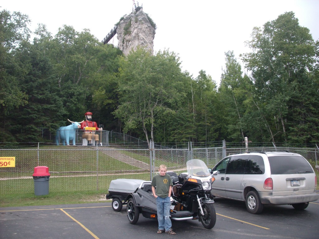

I pull directly behind the bike.It makes more cents to me to keep the forces of the trailor inline with the power source so as not to add anymore pushing and pulling off to the right side,not to mention the extra stress on the mounts.
I have no problem whatsoever doing this,Its almost to easy to forget the trailor is there.
I can park the whole rig easily in a standard parking space,spin it all around,pull up to any awkward gas pump,easily run at highway speed(although I prefer 2 lanes) and when on a trip, never unhook and leave it behind,thats where I keep my lunch.LOL
It is also a harbor freight frame,But I have narrowed it 7 inchs when I built it.

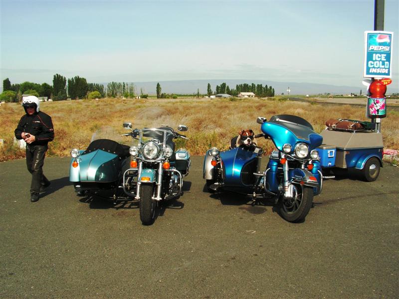

I've done it both ways, but prefe it between the bike and sidecar. This is especially important in inclement weather or on bad roads. Centering the trailer puts it's wheels in line behind the bike and sidecar wheel. That way you have only two tracks to straddle obstacles and potholes.
My current rig pulls the trailer behind the bike. I did this because my camper is narrower than the saddlebags on the bike, so I saw no reason to build a new hitch. I was wrong.
I leave four distinct tracks in the snow. The only way I avoid anything is by changing lanes, which isn't always possible.
