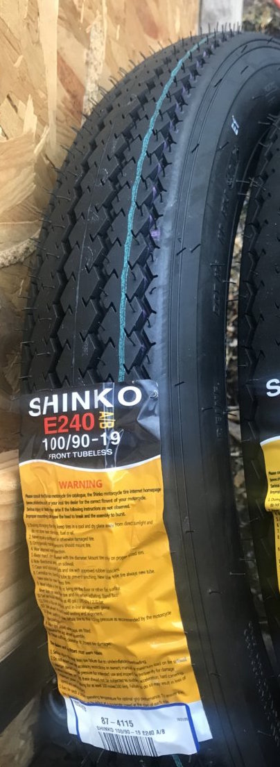

What other tires have you tried? Have you tried a Shinko 240 Classic? It's tubeless, nice profile, cheap.

DRONE, thanks for posted the Shinko E240 19" tubeless. I was unaware of this size for the E240.

Thanks guys, I have used Shinko tires and was happy with them but was unaware of that profile. I think I'll look into it. I had wondered about tube valve stem sizes compared to the tubeless stems.
