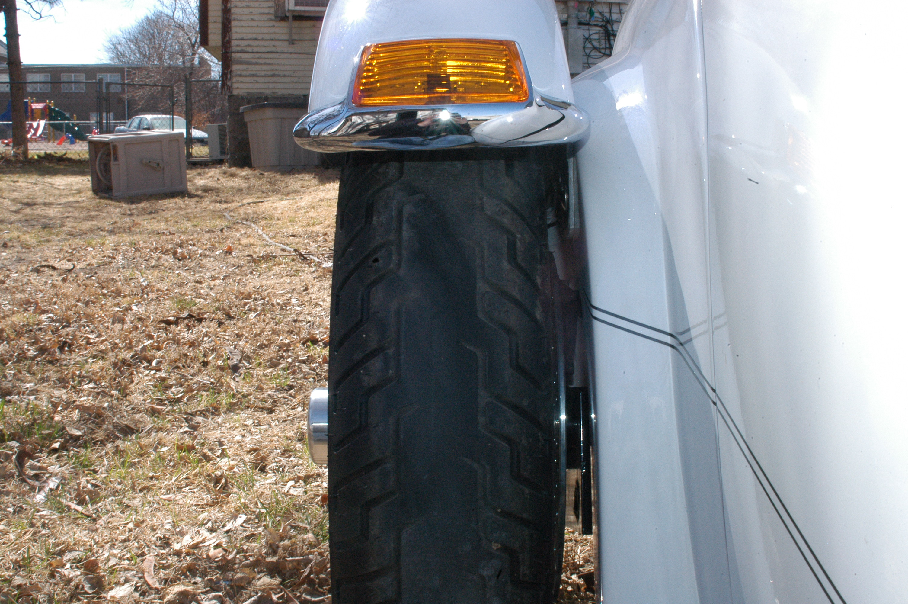

The tire on the sidecar is wearing in the middle of the tire. Car was installed last October and have less than a thousand miles on it. Have adjusted the lean out, but not the tow in. I will try to post picture. Any suggestions?
Posted : March 15, 2015 9:06 am
Check the edges of the worn tire tread.
One side will usually have a feather edge and the other side will have a rounded edge.
If the outer side shows a rounded edge and the inner shows some feathering, you have too much toe in.
If the inner (bike) side of the tire tread has a rounded edge and the other the feathered edge, not enough toe in.
Your leanout looks about right.

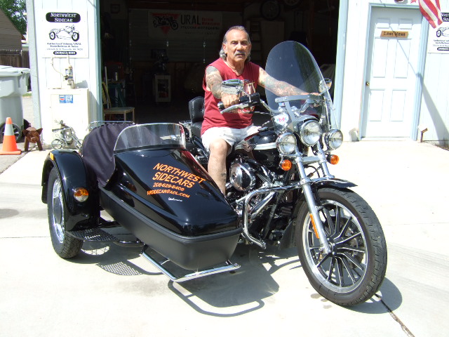

Your alignment is off and your tire is a bit over inflated. Here is a link showing how to set alignment.
BASIC SIDECAR INSTRUCTIONS.doc (388.5 KB)

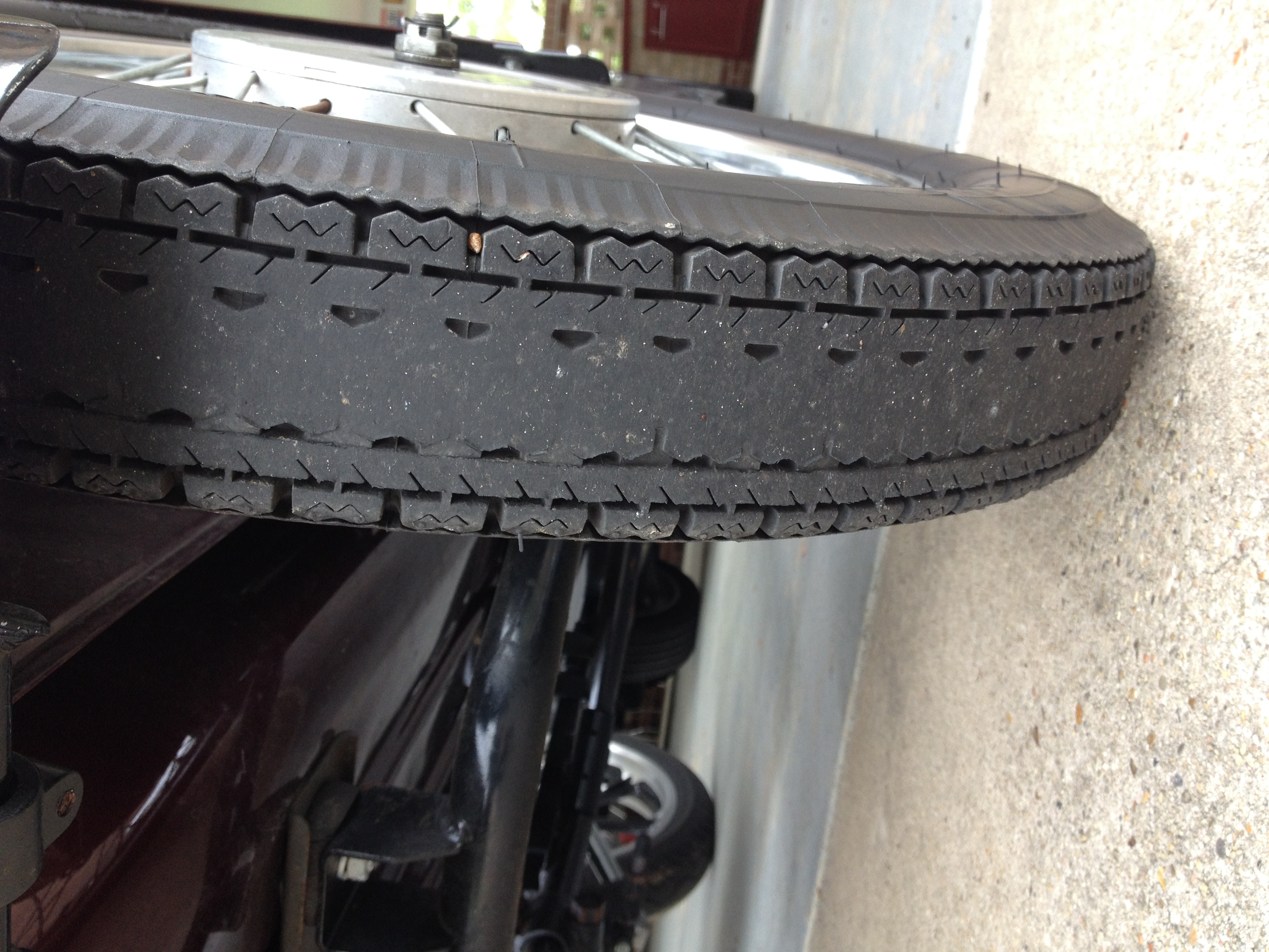

Man this looks familiar. Have the same problem on my Yamaha V-Star/Velorex rig. The car was running a 350X16 Heidenau tire built for sidecar use. Heard great things about them on this forum. Had to try one. Have just over 2,000 miles on the rig and the tread is gone in the center. Looked for feathering, etc. and could not see any. Mecs at the shop could not either. It looks like the tire is over inflated, but I had it down to just 25 PSI and was fearful of going lower. The rig is in the shop right now getting new tires for the car and the rear. Rear was factory original with a little over 10,000 miles on it. Could have gotten some more out of it but plan on doing some long runs this summer and want to be ready. Going to an Avon sidecar tire for the car. They are also checking alignment of course. Should be done by the middle of this week.
Posted : May 10, 2015 2:37 pm
(@mike-bodisch)
Posts: 237
Trying the pic again.

It looks like overinflation, but If the wheel is vertical (many Velorex's are not quite so) you may not have enough toe in.
The OEM Velorex 4 ply Mitas tires are very long mileage tires if the rig is properly aligned and proper pressure is maintained.
Posted : May 10, 2015 3:27 pm
