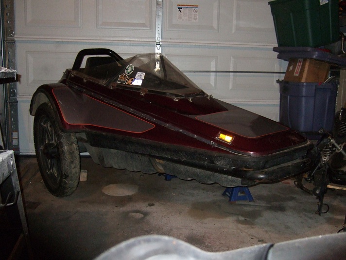

Hi, folks. I recently bought a Terraplane. It has a ASCA decal on the windshield (along with Honda and HOG). Burgundy with gray insets, orange tape pinstriping. I bought it in Russellville, AR, but it had never been mounted to a tug by the seller. If anyone knows some history on it, I'd love to hear it.
I'm planning my restoration, and wanted to know if anyone has the specs, or a part number, or a link to the edge moulding. I'd like to be sure I can get a replacement before deciding whether or not to separate the fiberglass. I think I should, as there is rust visible on the frame.
The brake parts are all missing except the caliper mount. I think I'll upgrade the brake hydraulics, but am interested in an original disk and pedal assembly if anyone has one lying around.
Anyway, thanks to all for this forum, it helped me to decide which car to get, and there's plenty more info to be mined. Pic here:

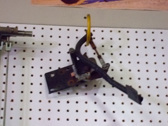

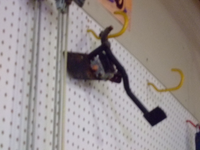

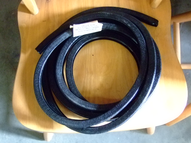

I have a brake pedal ass'y. with mount hanging in the shop and 16' of new edge trim moulding in the shop.

(@turbodog)
Posts: 17
Cool, Lonnie. I saw those from old posts, but figured they were long gone. Please send a PM with the $$ you need for them, and I'll get the tape measure out this evening to see if 16' is enough.
Thanks!

(@turbodog)
Posts: 17
Well, It seems I need 18 feet of the trim. So, after careful measurement, this is the trim I am buying:
V30-1312B25-1 by Taco Supply: http://www.tacomarine.com/item--3-8-Opening-x-5-8-Flex-Trim--V30-1312.html
I can get 25' for just over $50.
Hope it's the right stuff!
