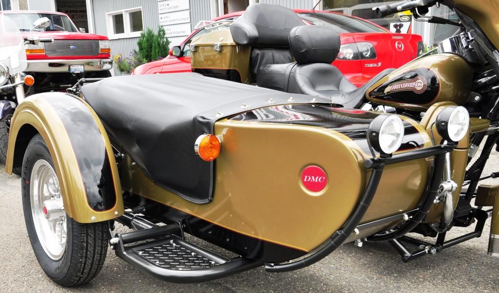

Liberty makes a nice sidecar. You might also consider our sidecars, the M72C, M72CX and the Expedition when mounted on the M72CX chassis. Some advantages over the Liberty, these sidecars are much easier to get in and out of as they have a step built into the sidecar frame, the body is cut down where you step in and the windshields fold forward out of the way. The trunks also open from the out side, seal and lock. And we offer electric trim so if it is pulling one way or the other you can trim it while riding.
