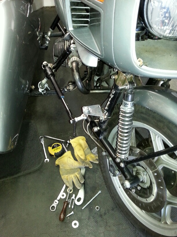

Here's a photo of how I attached my VW steering damper. I made the brackets up and they are adjustable so you can control how much of the piston travel you end up using and yet still allow the steering to go lock to lock. I've painted the brackets black, but they show up better in their natural state.
I found with mine I had very little wobble at slow speeds and then only under certain circumstances, right turn & or something similar. What I did find that with the leading link front end the steering was too easy and made the bike twitchy in wind and even a slight input at the handlebars greatly affected the front end. So I wanted to add back a bit of resistance to the steering, so therefore the damper.

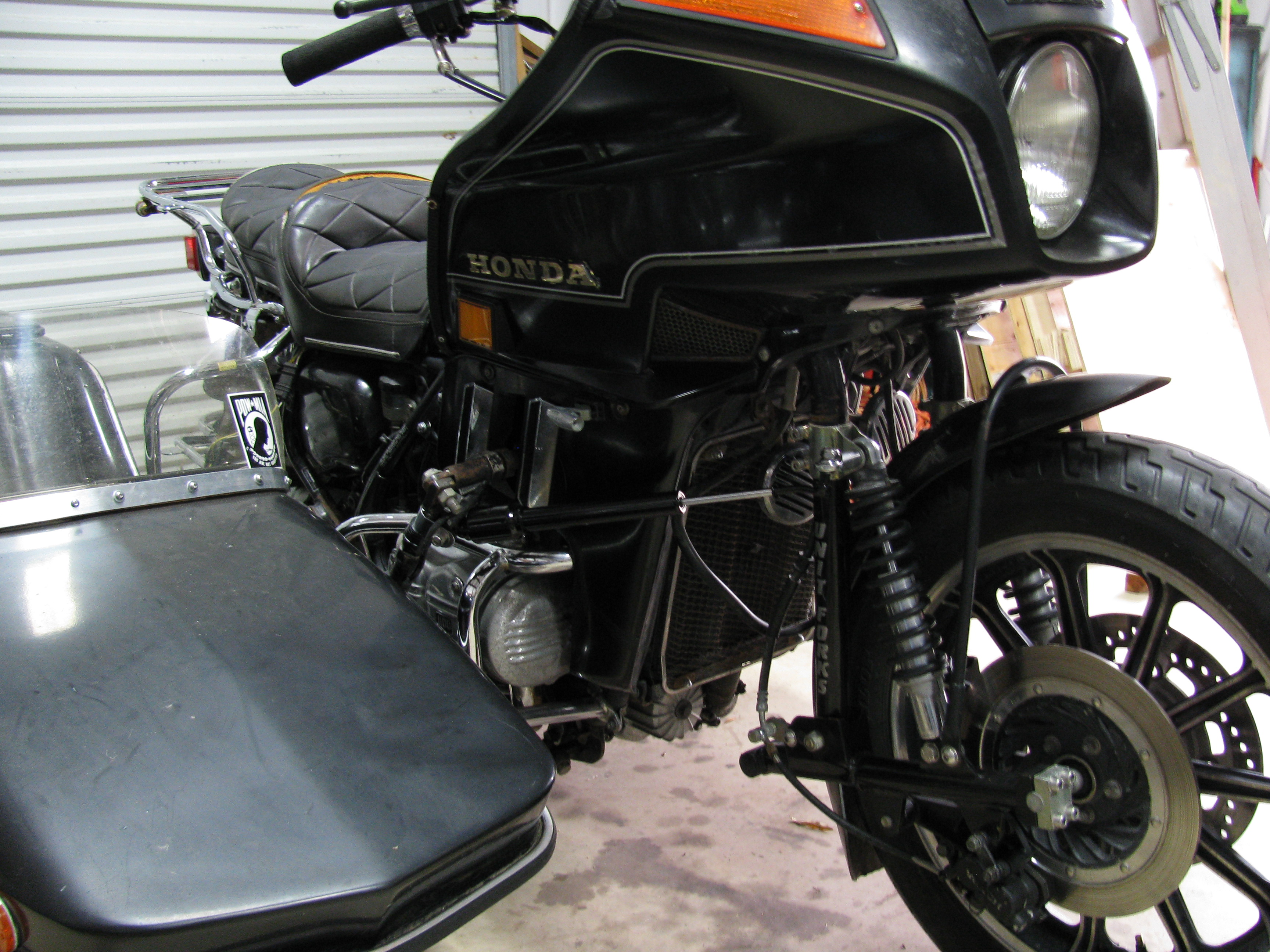

(@Gray-Rider)
Posts: 11
Thanks for these other replies and for the photo cycleman. I mounted my damper slightly different than the photo. I bought a peripheral rod end like in the photo, but mounted it on the top bolt of the right Link fork shock unit and then mounted the other end on the upper sidecar mount and mounted this way has fewer parts and appears to work fine. I will try to post a picture soon.

(@Gray-Rider)
Posts: 11
I'm trying to post a photo, maybe this will work.

(@cycleman)
Posts: 46
I originally had mine mounted similar to yours but found the damper was too stiff ( using too much travel of the piston and the steering wouldn't go lock to lock ). So I made the brackets and mounted it lower. With the set up know it uses about 2" of the piston travel of the damper. With out winters up here haven't had a chance to ride the rig, but it does steer easier when I sit on the bike in the garage.
