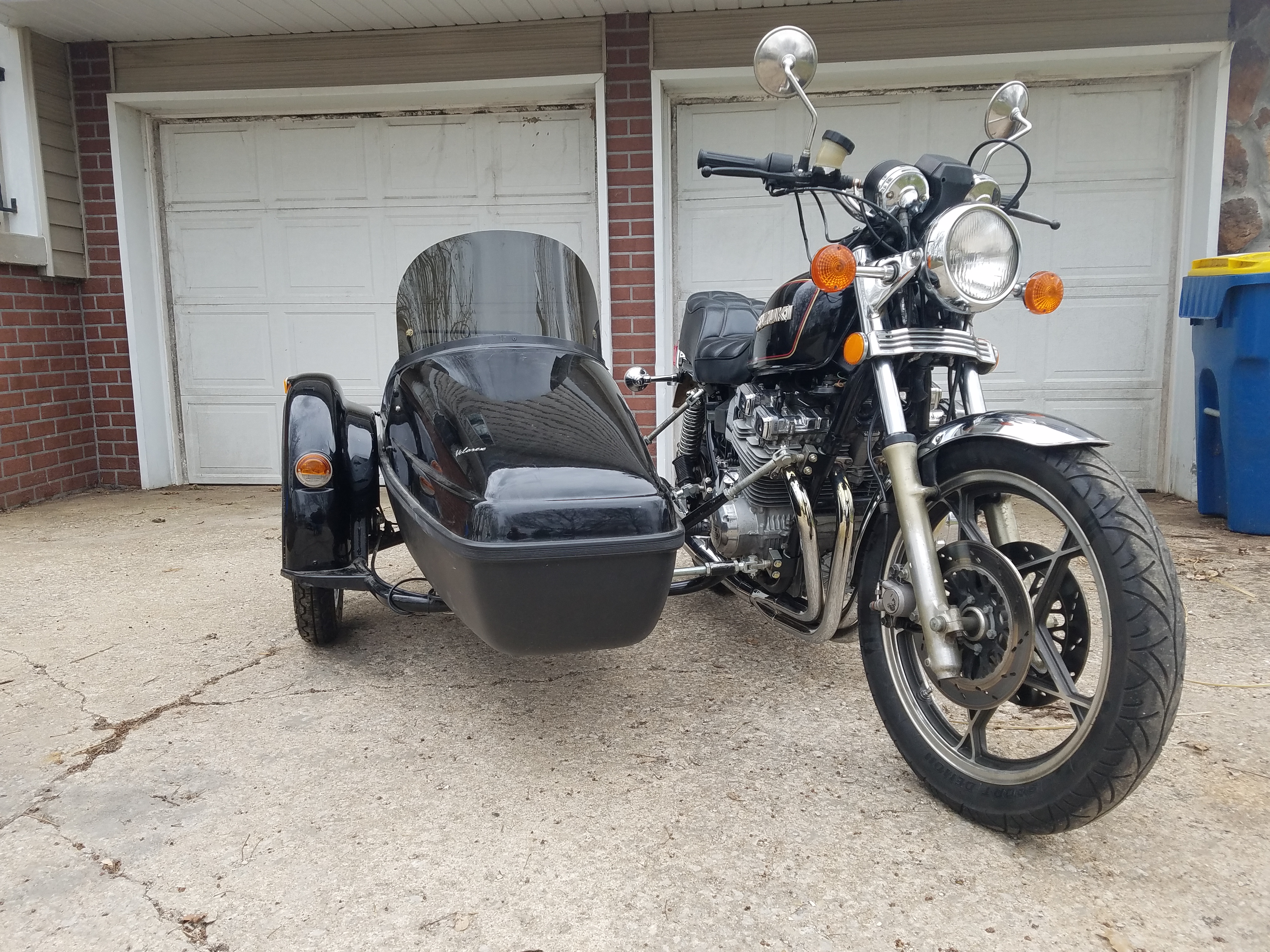

Hi all. I ended up mounting my Velorex 562 to a 1980 GS1100L. I took it out for a test ride yesterday and it did great, but it's pretty clear that the stock rear suspension isn't up to the job. I'm looking at upgrading to either Progressive or Hagon shocks. My question is, how do we settle on spring rate for sidecar use? I'm a bigger guy at 225 lbs, and I plan on keeping some ballast in the chair, say 1 60 lb sandbag and sometimes my 30 lb kiddo (once I'm comfortable driving this thing). The bike weighs 550 lb per Suzuki.
Edit: The pic is from when I was putting this thing together. A few things have changed/been finished since then. I was just antsy to get a pic of it.

Looks good Wolfe. If you haven't already you might consider flipping the upper struts end for end so the threaded portion with the locknut is facing down. Just something recommended to help keep water and corrosion out.
How clever! I hadn't thought of that. I'll take a look at doing it.

Do you have the 15mm axle on the Velorex? I'd seriously think about upgrading that if you do. I had trouble with mine on an 1100 Shadow, got to be about the same specs.
It's a 2007 Velorex, so it should be the 20mm axle, I think. Someone correct me if I'm wrong please.
Posted : April 19, 2018 9:05 am
That sounds right. I went overboard, mine's getting a 35mm axle, but pretty sure everything newer than at least 2005 has the 20mm. 🙂
