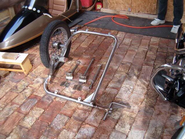

Here are a couple pics of an Eagle frame as my buddy was mounting it to his Vulcan.

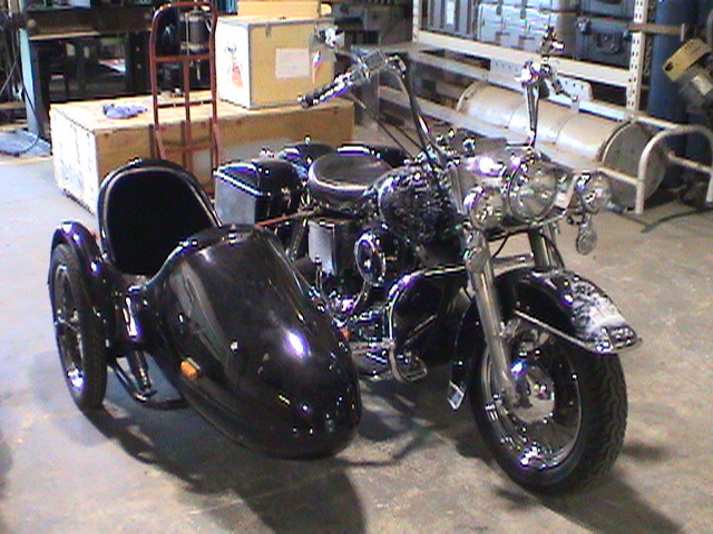

I know of the Spirit's being ran with FLH Harley's and earlier GL's and not failing. Not the best choice of hacks maybe, but they work.
The secret is in using adequate mounting methods, maybe even an added 5th strut. After that, adequate ballast and common sense driving habits will help make a fun rig. With limitations, of course.
Here's a recent mounting (not mine) on a Big Twin Harley.

I flogged mine for many years of abuse on my Hondasan. Used it to haul my tools from city to city on contract jobs. Worst abuse was giving a ride to my buddy's drunken 250 lb. (and then some) Ol' lady. Talk about draggin' on take off and divin' on brakin'! Filled with ice to make a make-shift beer cooler at one party. Never had a problem with those rear mounts, they stayed firm. I checked them regularly to make sure they hadn't losened. I was never real thrilled with the front lower mount when I had it extended way out for one mounting method I used but it was plenty strong when I changed the mount so that it was screwed in more. All in all I had a blast with it for nearly 100,00 miles (maybe more...) and the kids loved it.
I'm rebuilding it now for another go around another Honda, this time a VT1100T.
A fun chair at an entry level price. If you like it you can always spend more later for a bigger, better hack. Mount it strong, you won't go wrong.
