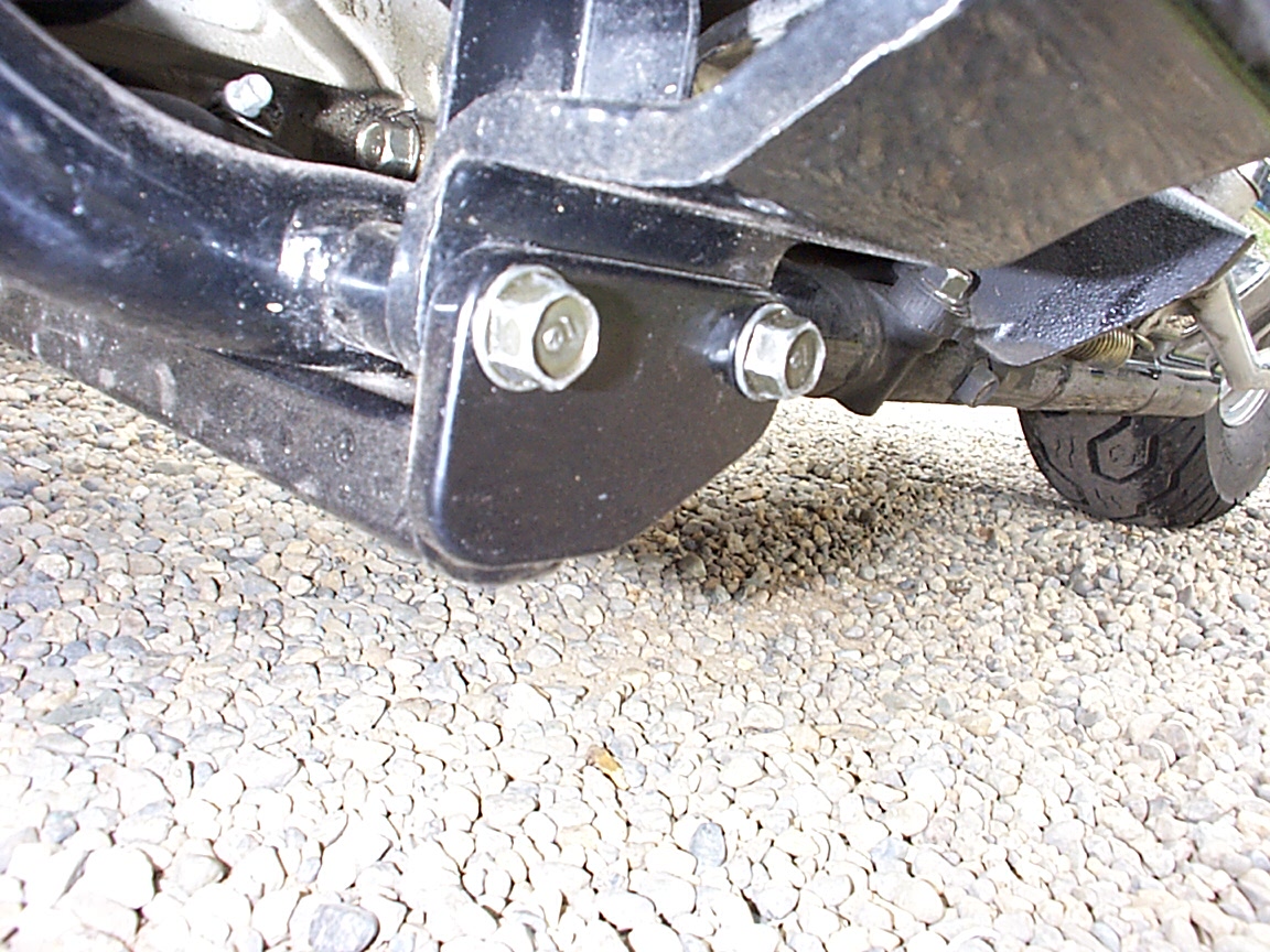

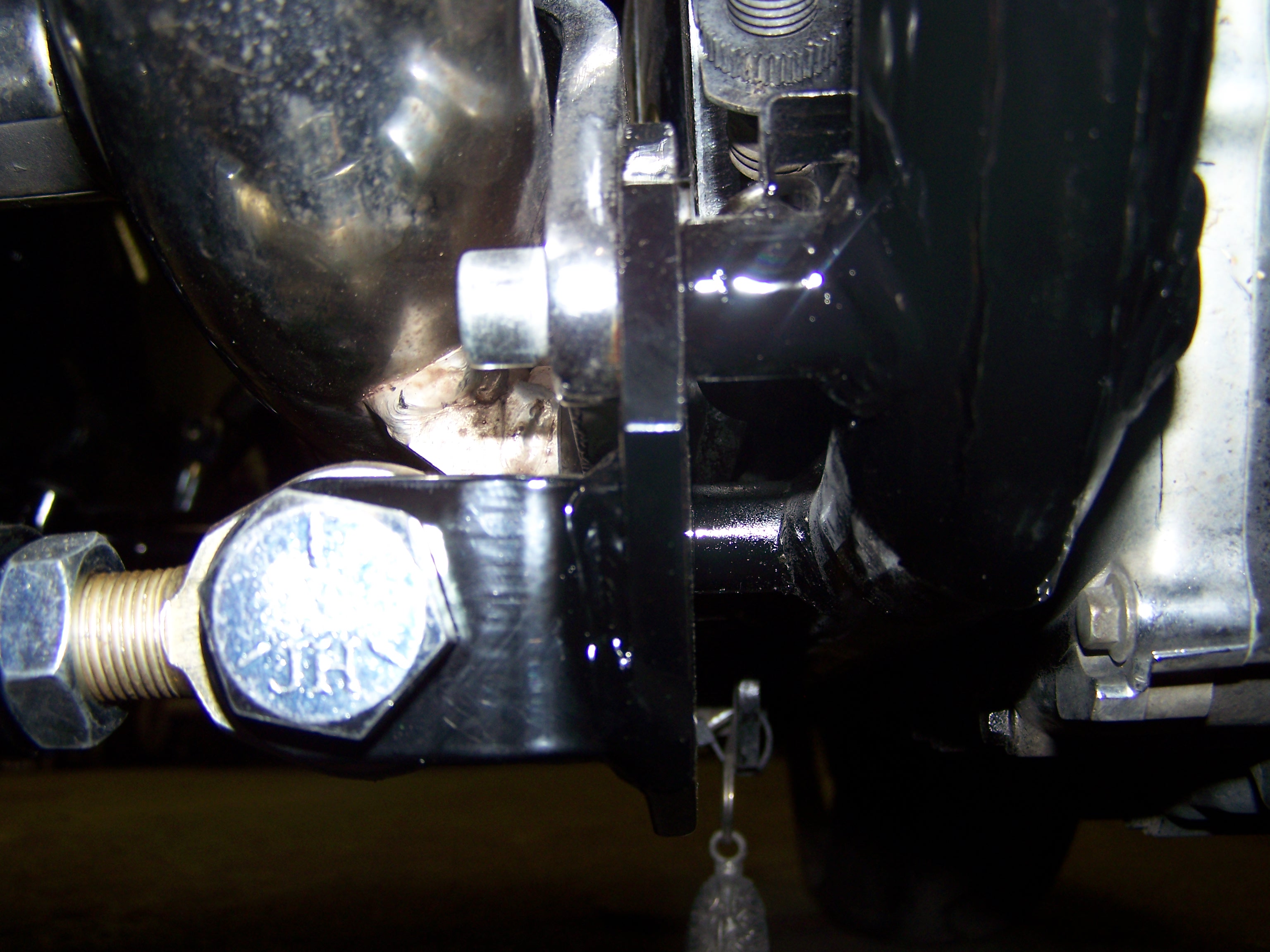

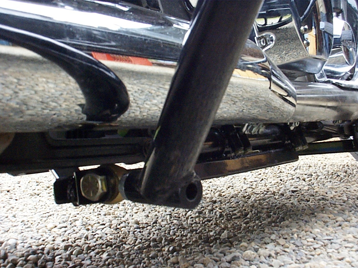

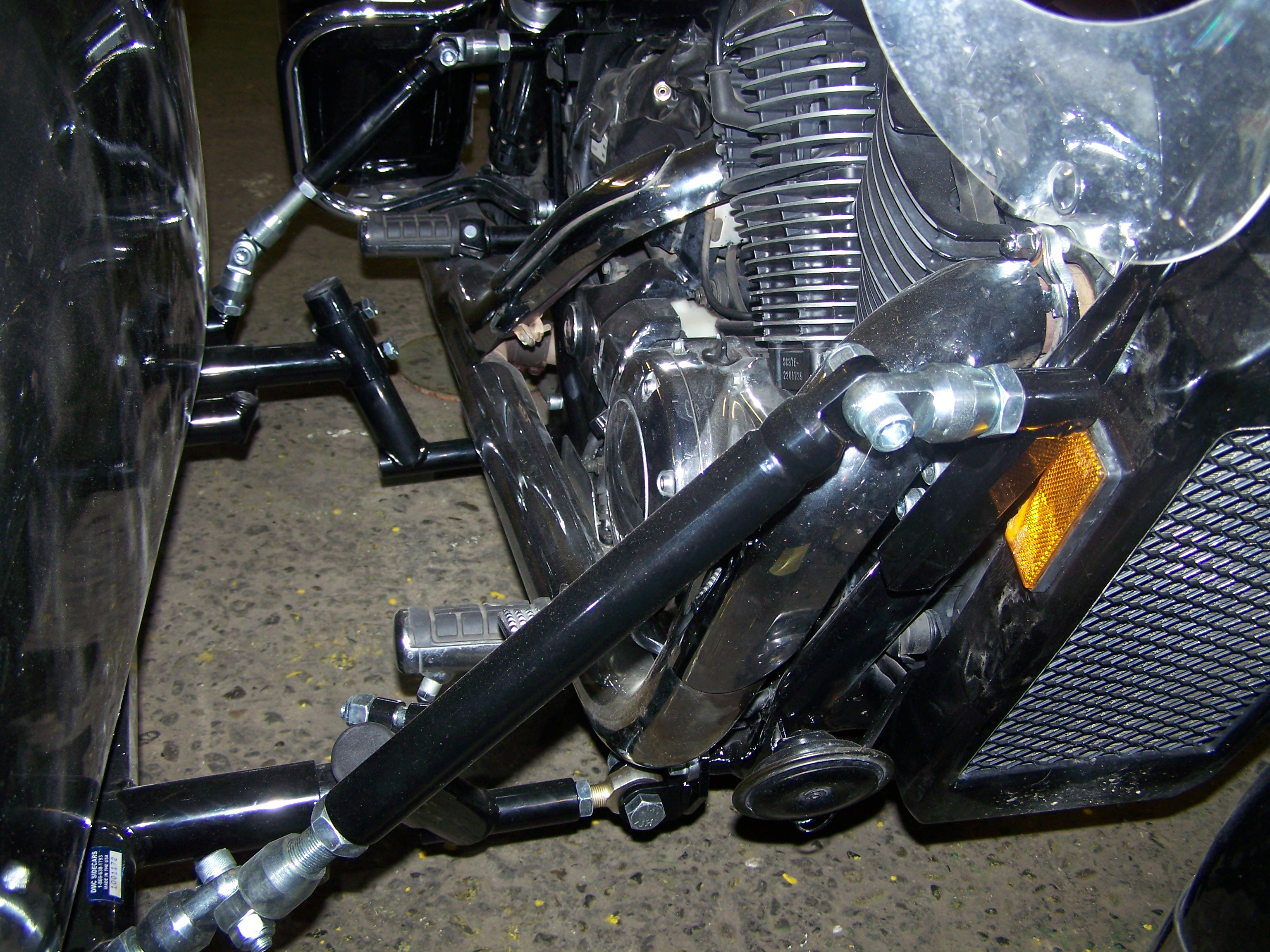

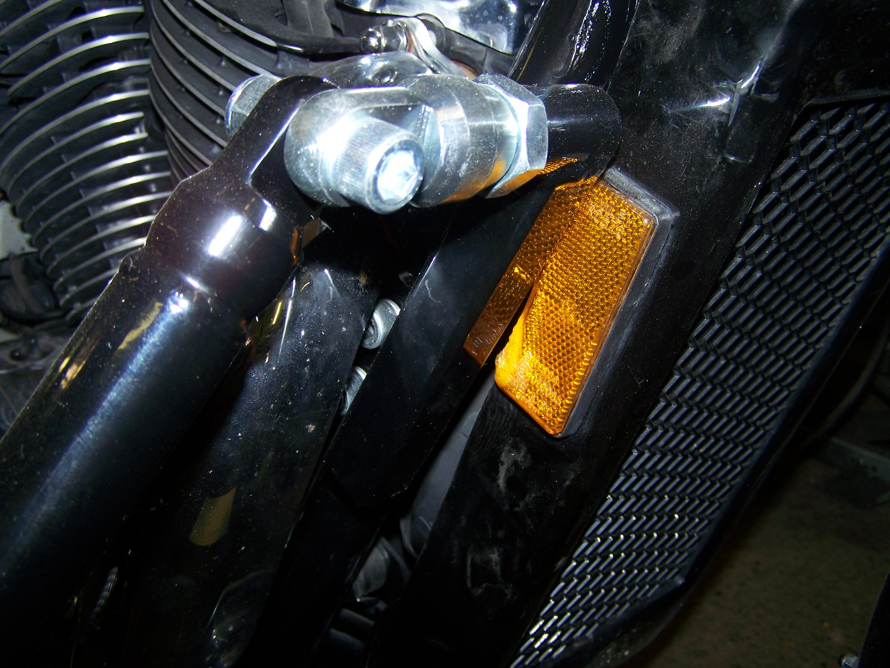

We do make a bike specific mounting kit for this bike however the Velorex is a bit on the light side for a bike of this side. For our mounts we make a small sub frame for the lower rear that clamps to the frame under the muffler and crosses over to the other side of the bike. This moves the rear lower almost in line with the front of the back wheel. The upper front picks up both of the bolts used to split the frame and moves the mount to near the top of the radiator. The lower front mount picks up two of the bolts that hold your foot peg assembly on and the upper rear mount picks up a bolt for your passenger foot peg and also tucks under and is held in by the upper shock mount. This moves all 4 mounts as far apart as practical and puts the lower mounts equal distance from the ground which by doing this when you change your lean out you do not change your toe settings as you would if one of the mounts were higher then the other.
At this link you will see the changes we make to the Velorex frame to make the lower front mount adjustable and the lower rear mounts stronger not likely to move like the standard clamp does. http://www.dmcsidecars.com/the-result-of-improper-sidecar-mounting-and-the-proper-fix/
I have attached photo's of what our mounts look like on the bike. You will see that they move the 4 mounting points quite a bit apart from each other making for strong triangulation and as such a ridged firm mount that will hold an alignment and make it so that you should be able to do with out a steering damper. Dampers are often but not always used to cover up a poor installation and or alignment.
