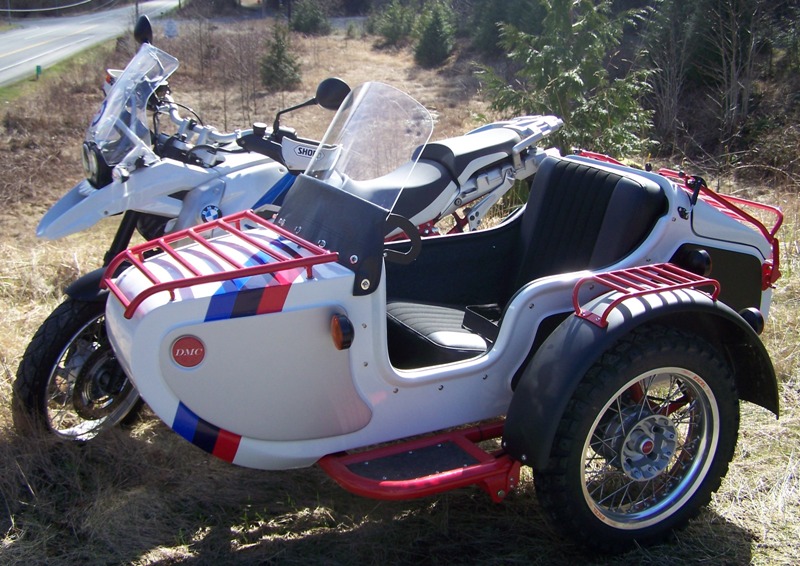

We export our sidecars to Australia and none of our customers have ever had issues needing reverse. We are shipping one of our Expedition sidecars this week to Australia and I am sure that there will be no issues.
We do have a way we can add an electric reverse but it is ugly, complicated and we usually only use it for people who are disabled. We start with a winch, make a drum to where the cable was and then use an actuator to pull it against the rear wheel of the bike.
I have attached a photo of our Expedition sidecar like we ship to Australia.
Posted : December 5, 2014 4:09 am
