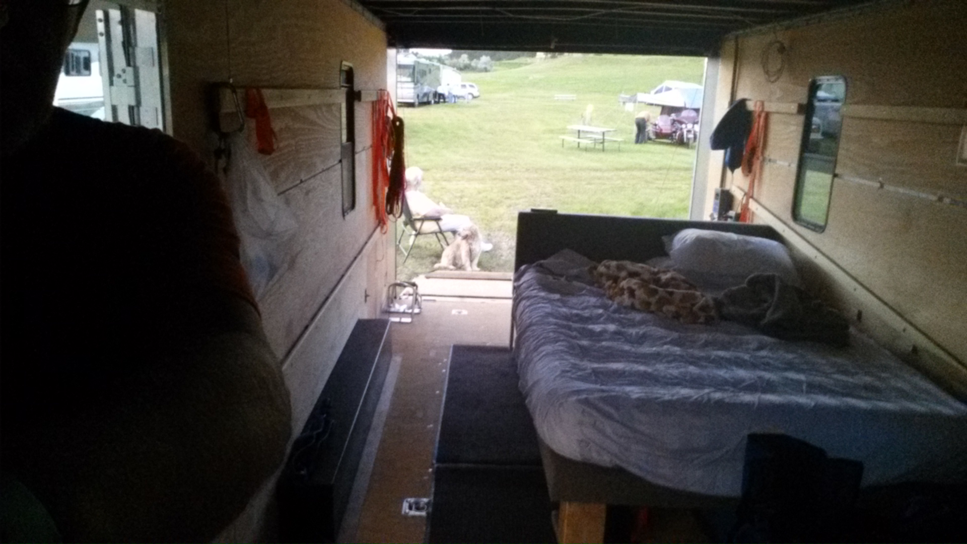

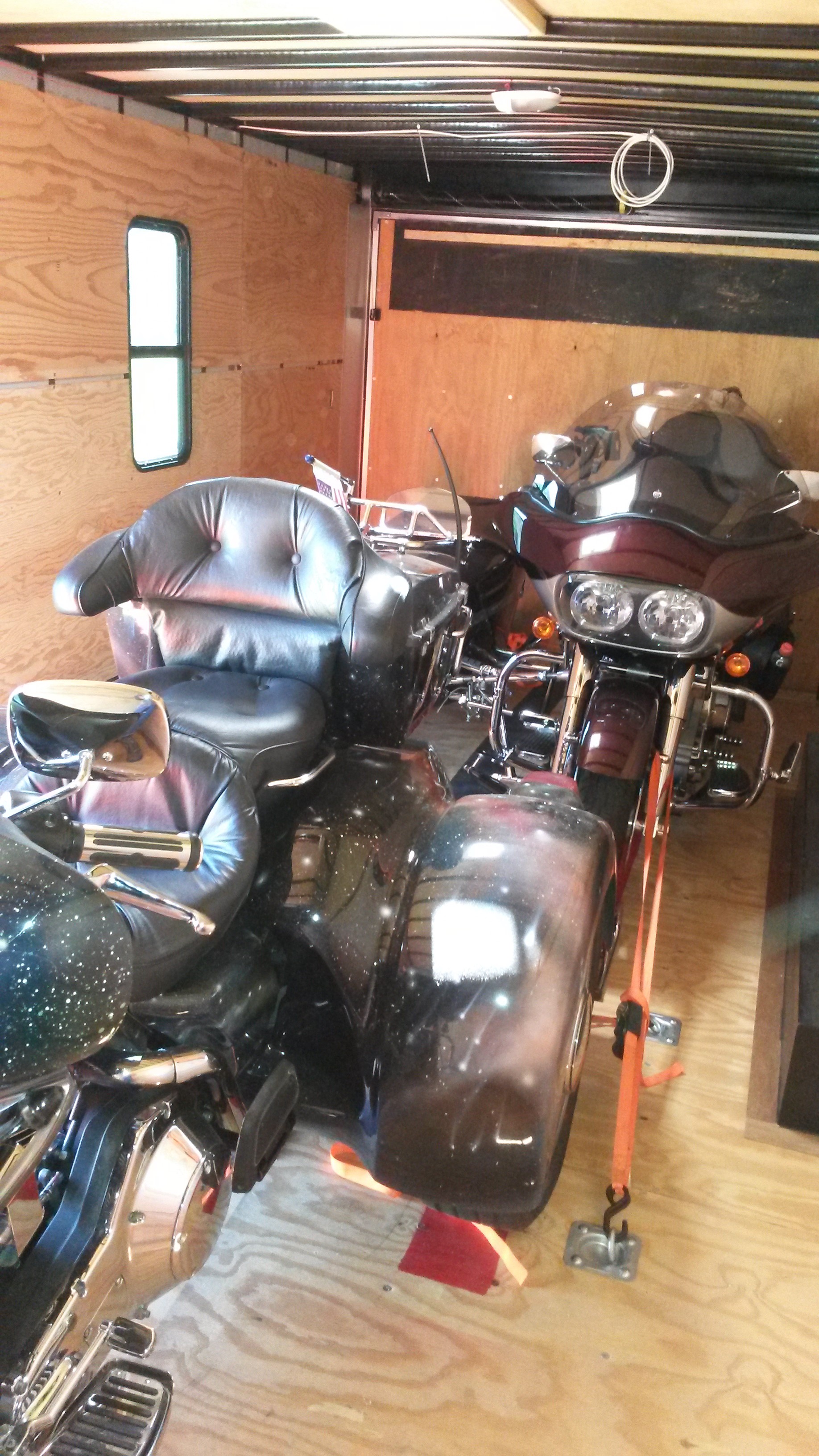

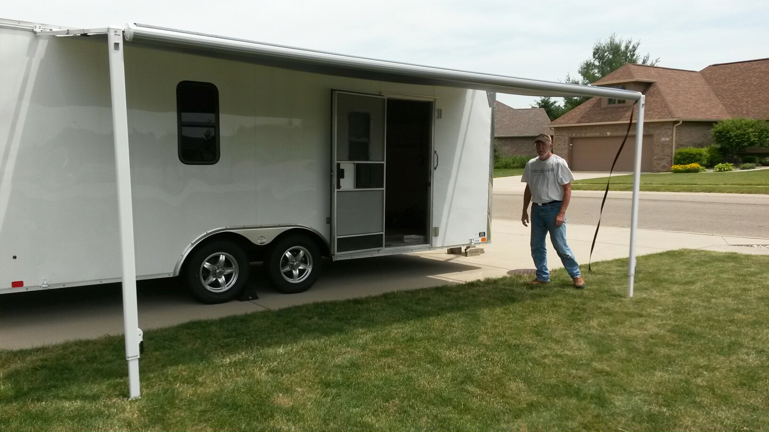

I've seen a few questions on this forum and others about sidecar trailer requirements. In 2014 when we ordered our Motorvation Spyder, we asked about trailer size suggestions. 7' wide enclosed utility and similar trailers would not suffice, a suggestion from Motorvation. We purchased a Car Hauler, 8.5' x 20' from an Indianapolis local dealer of United Trailer products, a UTX 20. The attached pic shows the initial pick up fitment in Iowa a year later. We have hauled both her Trike Conversion, the Sidecar rig, and a few accessories on several occasions. Since the initial pick up, the UTX has been insulated, electrified, windowed, doored, and canopied.
But for a Spyder on a Harley, a 8.5' car hauler works.

Camping platform, Even better! The other reason for the car hauler....

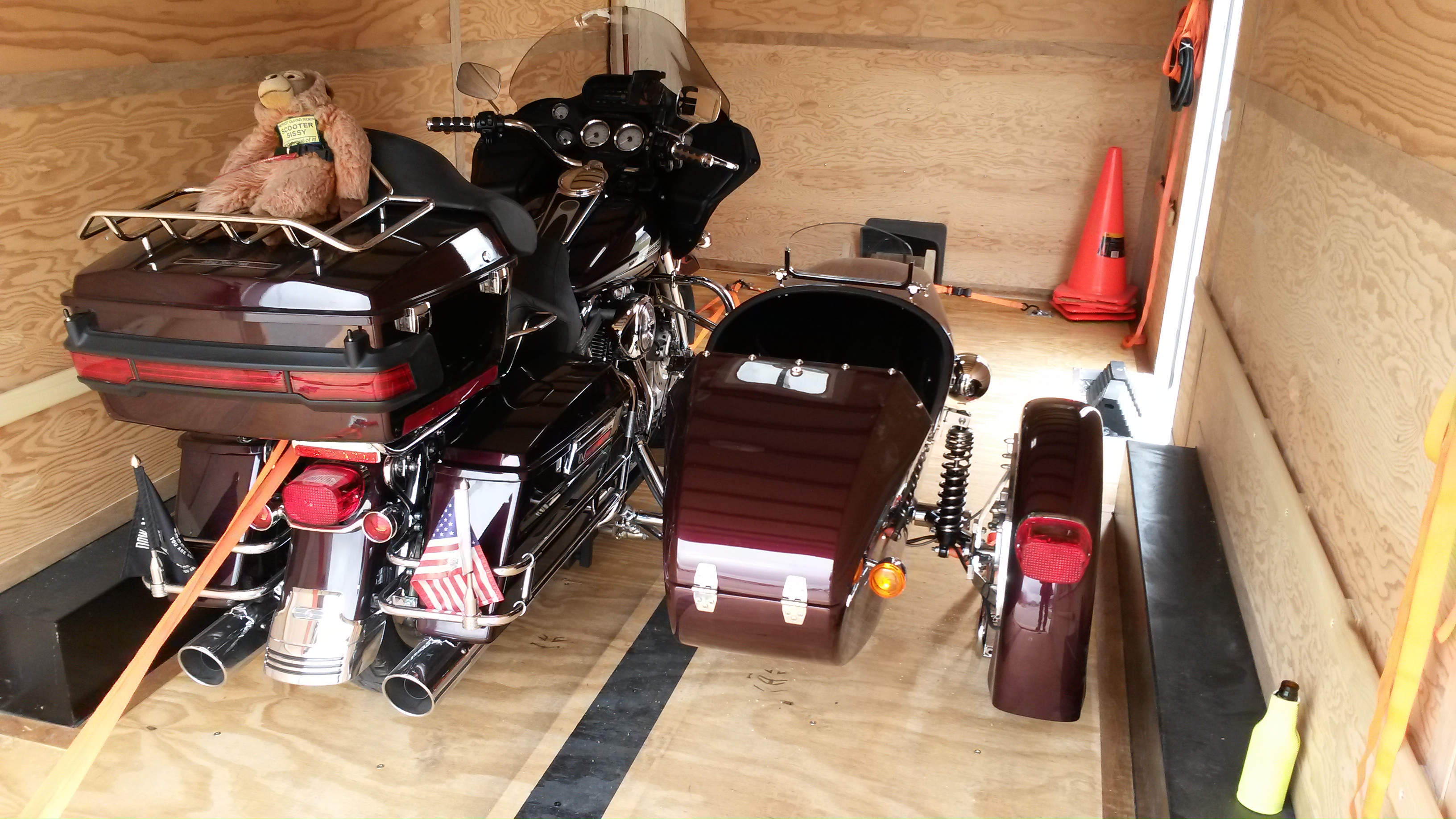

I'd originally bought a 7' wide that the FLH/Liberty barely fit in. Then, once inside, it was a pain to dismount and to move around to tie it down. My son wanted that trailer for his dirt bikes. OK... That worked well, I bought an 8.5X12 that is much more suited to the purpose of rarely hauling the rig in the first place. It's only money.

Ralph, if I could have found a 7.5 wide at the time I bought the 7 wide, I'd probably still have it. And after I sold the 7 wide to Seth at his request, I'd planned on getting an 8 wide but 8.5 is the standard so I went with that. Glad I did. My original thought when I got the narrower trailer was to see better out my mirrors. I bought mirror extenders to go with the new trailer but not real sure they're necessary. The FLH rig fits the new trailer like a dream. The Dyna/Spalding rig is so low to the ground I haven't had it inside the trailer yet but to load and unload, I'll have to find enough of a hill that the ramp door will be a lot less steep than it is on level ground. A bit of a challenge.

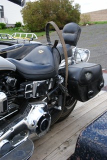

Good thought. Thanks Richard. I'm going to take the side stand off and see if that will give me enough clearance. If not the blocks would be easy to have along... And I've got the open trailer that tilts for an option like when the belt broke here in my driveway. Best possible place to break down!

Good point on the open trailer Mike. I have both, an enclosed (new and so far unused) and the open tilt trailer. It's the one my Dyna with the broken belt is on above. The advantages to it are the fact the whole trailer bed tilts so other than winching the disabled bike on there is no high center problem like with the ramp on the other trailer. And it's much easier to tie down on than my too narrow enclosed trailer was. But like you say, less protection on the road. The main advantage to the enclosed trailer is that it serves as a "poor man's RV" on the rare occasion I'd trailer to a rally. Those cases being if I'm helping put it on and transporting tables, coffee pots, chairs and the like in the pickup with the rig in the trailer. I had a tent made for the previous trailer that snapped on the rear of the trailer and the ramp on jack stands for a larger living space. Too expensive for no more than it got used. I passed it on to my son when he bought that trailer from me of course.
