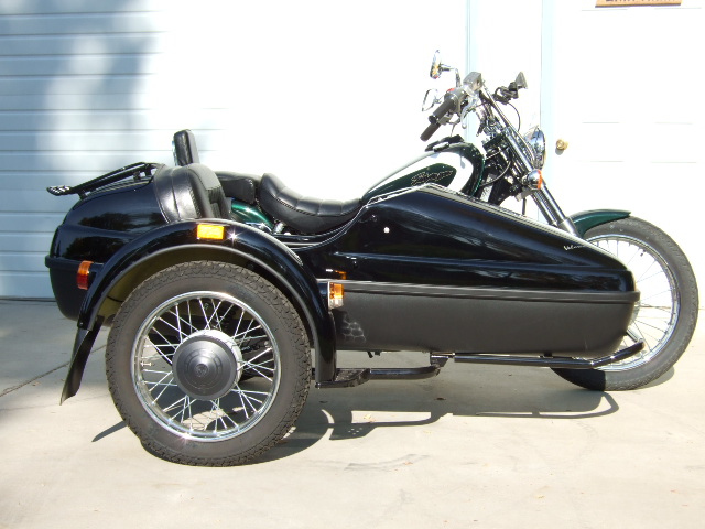

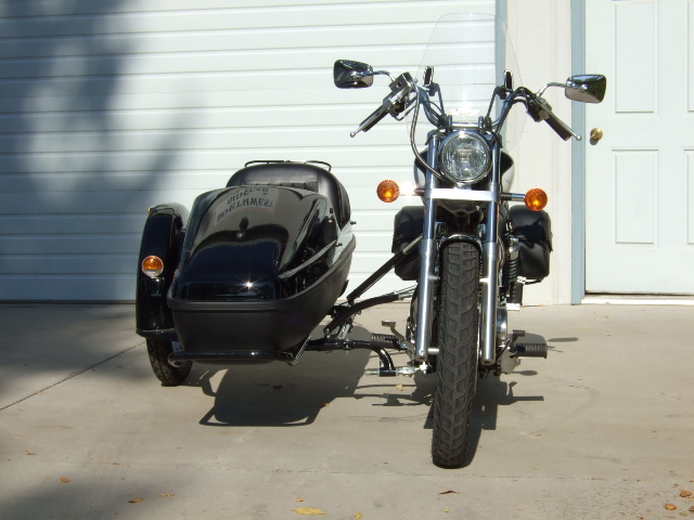

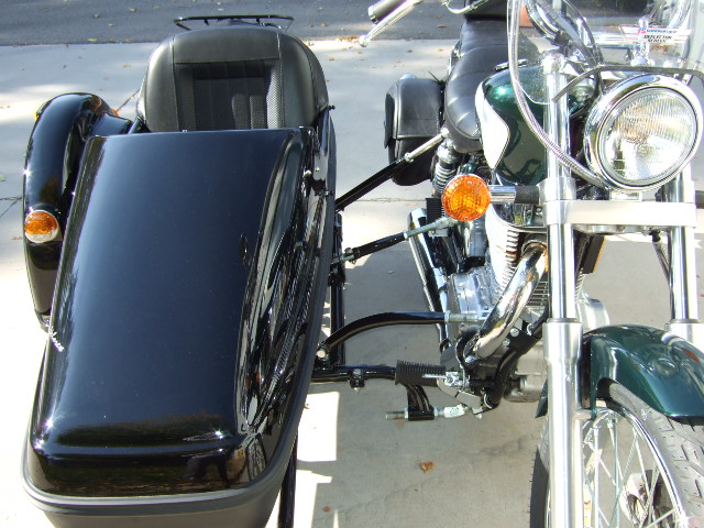

Pictured rig is bone stock. Will do 55-60mph all day long.
Owner has severe physical limitations and wanted a steering damper but I would recommend wider bars to control the minor nose wiggle for a person with average upper body strength.
Posted : October 17, 2009 4:45 am
I'm running an '03 Savage with a Cozy BUllet now. I did have the subframe & rear upper mount made by Dauntless Motors and they rigged the car from the homemade job the previous owner did. Not cheap but solid as a rock. Will run 55-60 easily, tug mods are stock airbox and carb with 1 size up main and pilot jet, stage 2 cam, SuperTrapp muffler from a Honda XT 500 RVFC (actually bigger ID than the ST sold for the Savage). Lonnie has had good experiences using the clamps from Velorex. If Phelonious checks in he is running a rig similiar to the one Lonnie pictured. Be sure and visit the suzukisavage.com site for lots more information on the tug mods and if they are needed. If I was starting over again, I'd probably try to find a operational rig I could ride and verify it is right. Mine wasn't and it added to non recoverable costs. Max
