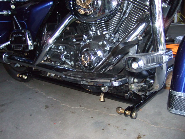

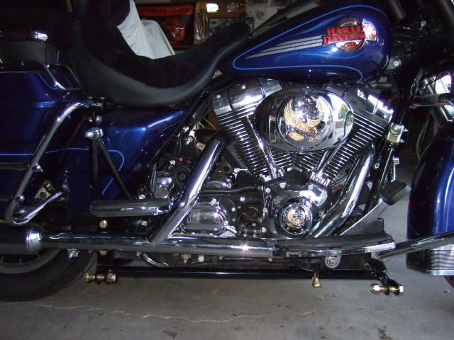

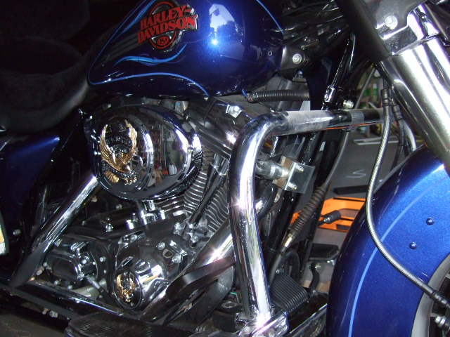

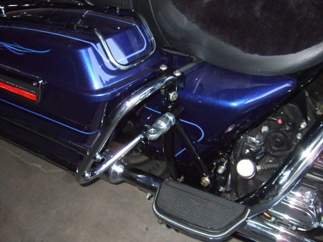

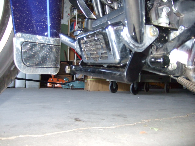

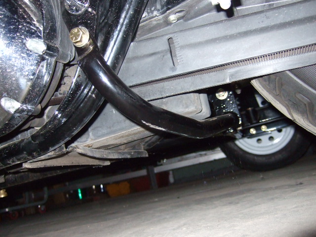

Here's an '06 mount setup. The '05 is the same. You need sub-frame mounts for the Electra Glides. A lot different frame than the Soft tails.
A Kenna sidecar installation shown here but the CSC uses the same type of mounts.

Thanks for the reply but I still have a problem the bike I have dosn't have the crash guard at the back also with this mount the frame would have to be removed to ride solo any ideas Thanks agan Ros
