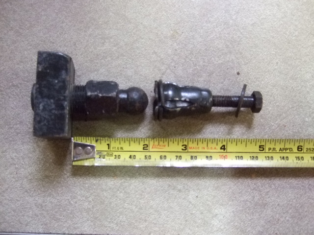

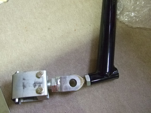

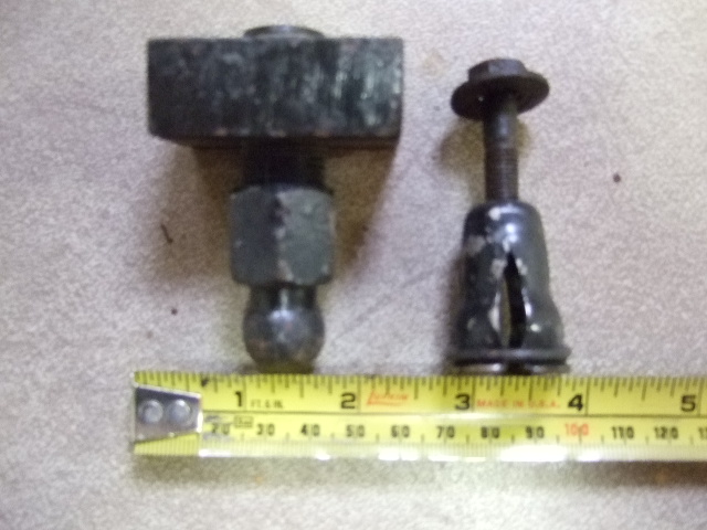

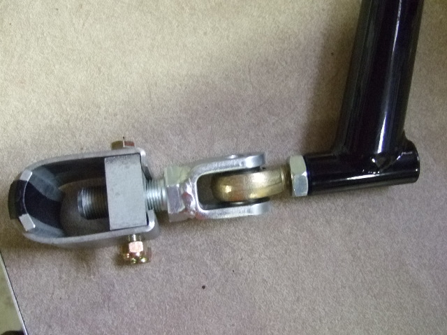

Loon (and others),
FYI: here are the three types of CSC lower mounts from earliest to present.
The earliest style shown is mounted FS I to Honda. Very shakey setup.
The tiny ball and flower for the collet style used up until 1989. Also questionable.
The Heim (rod end) and clevis used since. Very safe mount used by many sidecar manufacturers today.
Eye to eye and Eye to clevis mounts are also common today and offer safe sidecar mounting.
