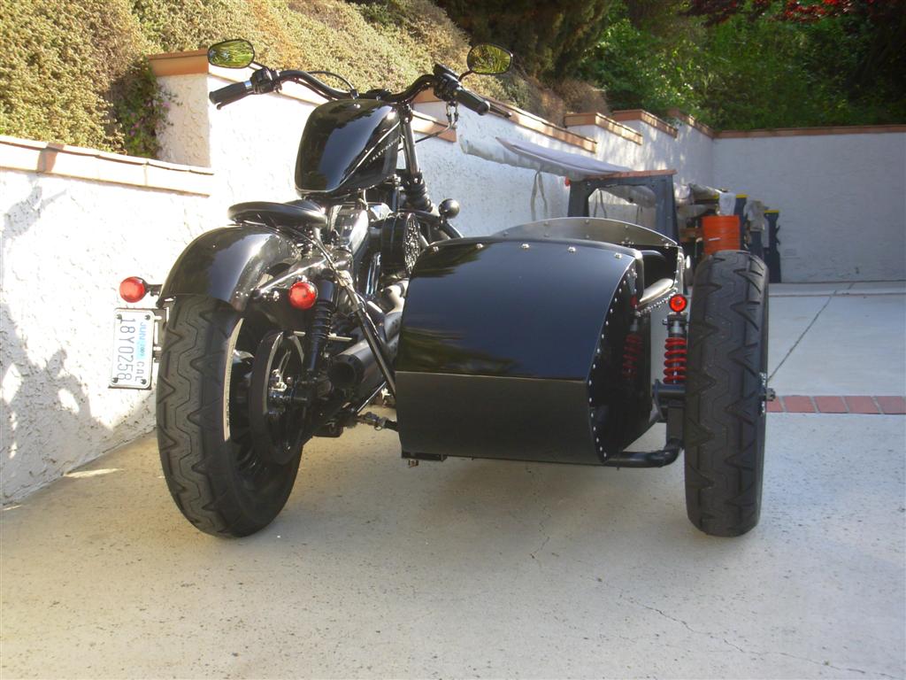

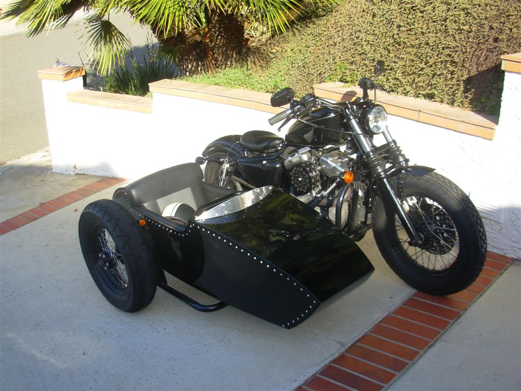

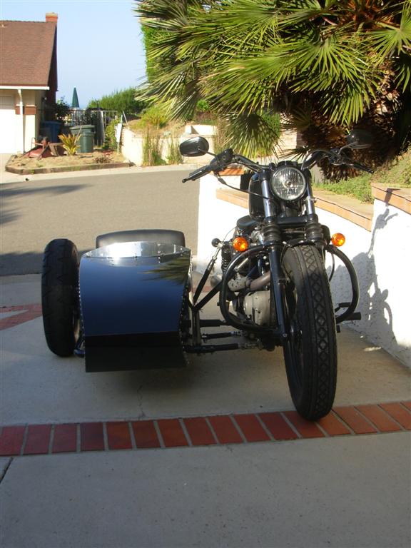

Here are some pics: 07 Sportster 1200 with TM 601.

Why no fender?
Posted : April 4, 2009 8:18 am
struds are not ready yet.
jorg

That is an awesome looking setup!!!! You'll have lots of fun bombing around town in that:o)
Thanks for sharing, Wes
Posted : April 5, 2009 5:50 am
Jorg,
That's a Great rig. I really like the style.
