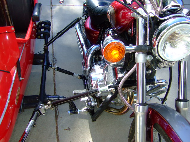

Maybe something like this? Subframe & some Velorex mounts.
