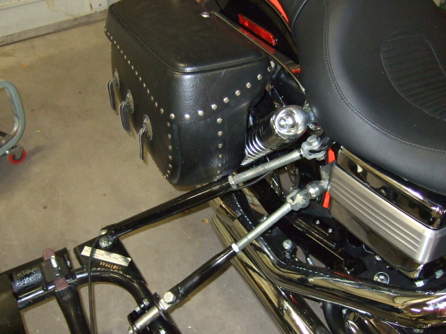

Placing the mount below the rear part of the frame seems quite close to the road.
Higher mounting has worked for me using a sub-frame bracket mounted beneath the seat for the upper strut position (as shown).

Thank you Claude I plan on calling Gary tomorrow and trying to get a clearer picture.
And Lonnie that was a great photo. My Tomco sidecar and Hondamatic are much closer together, approx 8 inches, than the ones in your photo. Maybe can move them further apart and then move the mounts up and avoid the Dyna exhaust and point the clevis down to the side car like in your photo. Have any more pictures of a sidecar and Dyna?
