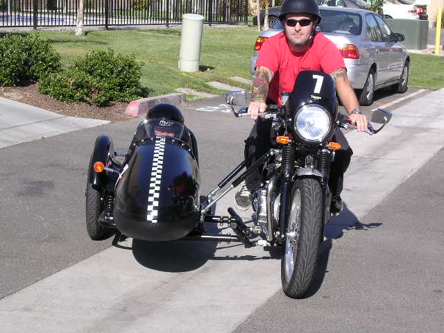

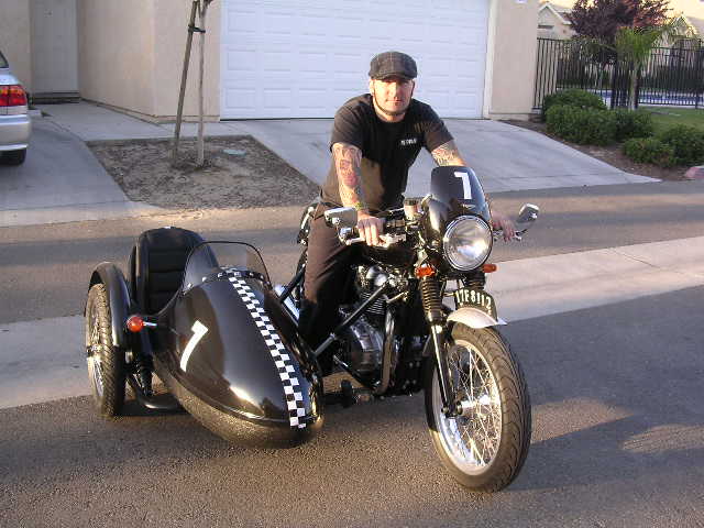

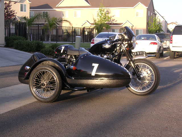

I finally got the Hack hooked up to the Thruxton. I have some adjustments to make (so that I dont get the knee slapper going on like I did when I first took it for a test spin!). But the overal big part is almost done. Anyway, just wanted to share some pictures of the rig.

Nice and the bike aint bad either.

Looks like an American Spirit Eagle sidecar. I use to have one. I never got mine hooked to the bike though, I sold it to K-Ray in Chicago because I got different one. Very nice setup, they look like they belong together. That knee slappin' typically happens at those low speeds around 25 mph or slower. Just keep a firm grip on the handlebars at the slower speeds and then you can ease up a little as you gain speed. I don't know if you can put a steering dampener on it to cure that problem, that may be a question for Lonnie or Claude. Take care, Les

I to thought that the hack and bike look good together. As for the knee slapper, it was more than just a little, it was HUGE.....so that leads me to believe that I need to adjust a lot more. I think the hack is actually fighting the direction of the bike so I need to re-measure the thing. Heck, I am stoked that I have made it this far. Thanks for everyones advice on here as well as other web sites. I have never had a sidecar or experience so this is completely new to me........but I already love it!!

That's a good looking rig, they look good together, I think part of your tank slapping problem is the lack of leverage on the bars, there just to narrow, maybe if you had a earls type fork on it you could get by with the clip on bars,,,maybe, it would definitely help.

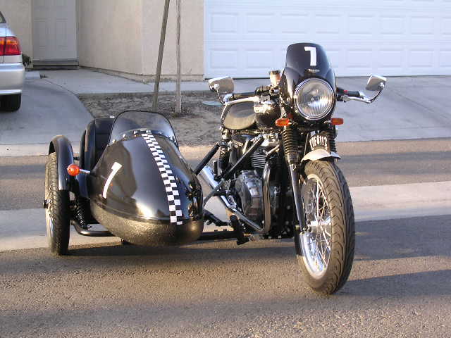

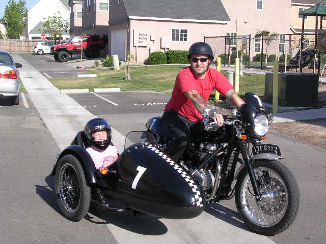

Thanks for everyones help on answering all the questions. I added my steering dampener and the wobble has almost gone away. Sweet!!
Here are a few more shots of the set up. I took the kid and wife (seperate times) around the block and they loved it (the wife said she would rather ride her triumph BUT she said it was cool!)

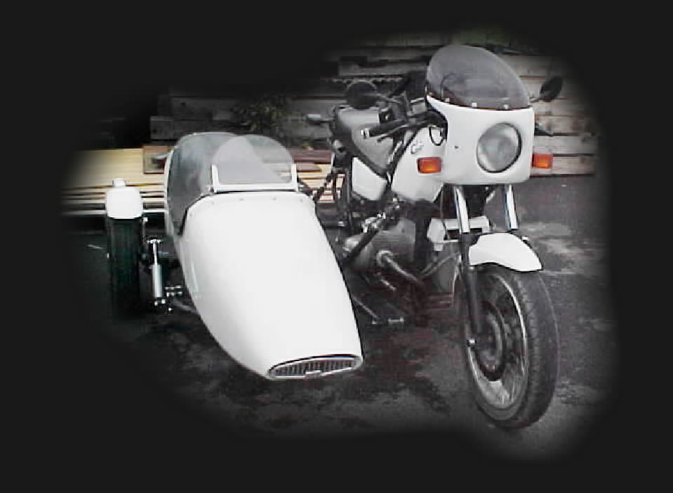

My current rig is a BMW R100R with K100RS bars on it that I have widened a little. It wobbles and steers hard but is fin ewith me for now. It has on eof our Freedom Cruiser sidecars on it..see attached picture. I think you sure got me beat as far as 'the look' goes 🙂

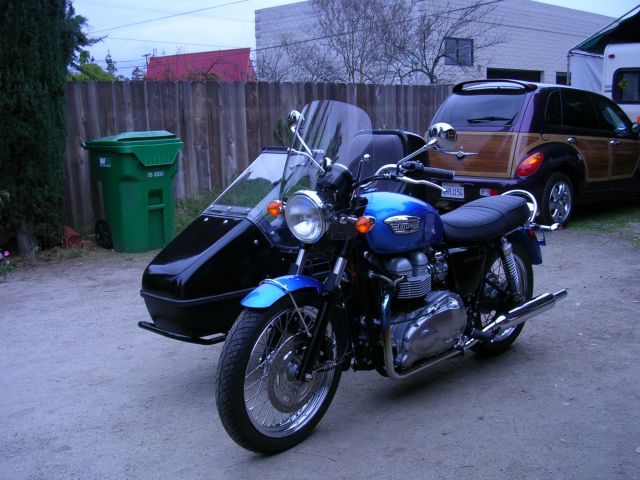

...Wot a sweet set up you got there...ive got a 900 bonnie with a chair i'm going to marry to ...any comments on were and how to attach the two ? welded or bolt on fixings ?..mines black as well...thanks, doe doe
Posted : February 10, 2011 7:08 pm

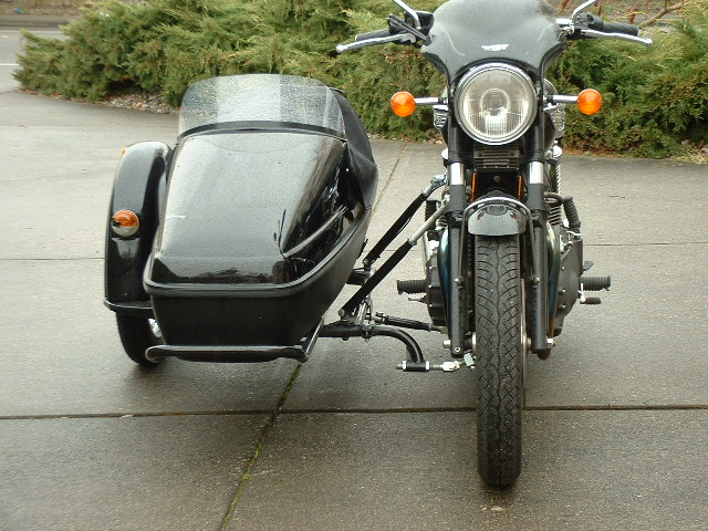

Here's a couple of Bonneville Rigs.
Posted : February 11, 2011 5:46 am
