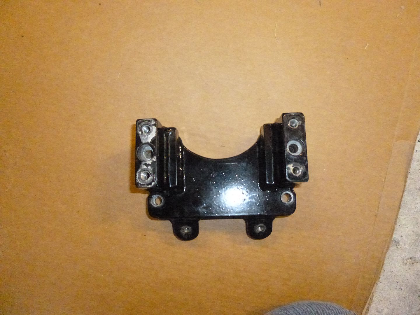

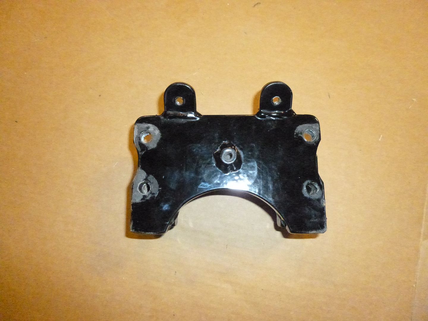

Front end had a spacer block under the front fork brace (one of the LONG spacer bolts had snapped off in the fork slider boss - replacement set of bolts on order), assuming it's there to adjust the steering. Spacer raises fork brace about 2.5" and moves it back 0.75"). Successfully removed the remaining bolt stub, and rebuilding fork slider guts while apart (including the lower bushing not shown on BMW's parts fiche!). Looks like there are a couple of folks that make this spacer, hoping someone can ID the source of this one, and maybe provide bolt torque/installation information...

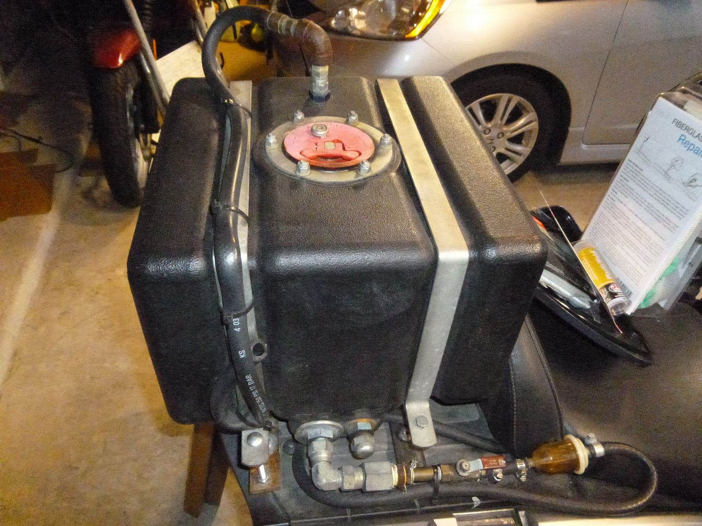

There's a 5.1 gallon fuel cell on the back, with some really interesting hardware-store plumbing parts attached. Thinking this plumbing could/should be cleaned up. But I think by the time it's done, it might be easier to replace with an aluminum fuel cell that could reside underneath the OEM trunk, which I'd like to re-install... Any clues on the source of this fuel cell, or a source for the "trunk compatible" fuel cell I've read about here...

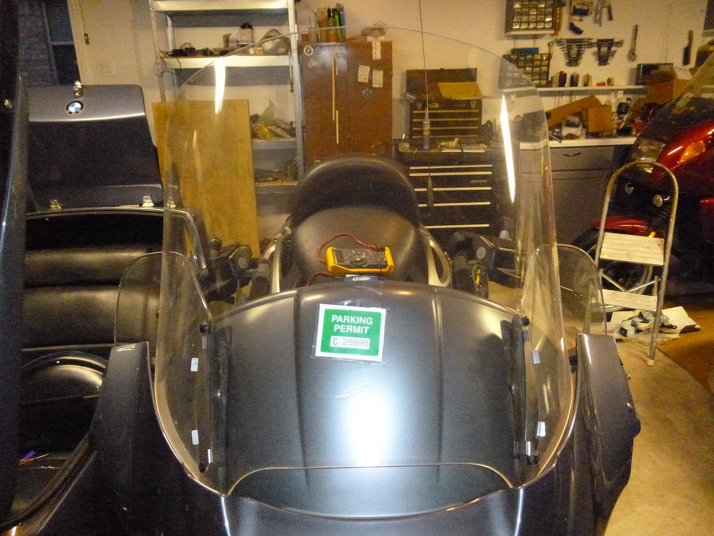

Finally, the bike has what appears to be a non-BMW windshield (Parabellum?) - before I take about 4-inches of height out of it, just curious if anyone recognizes it... 19.75" measured from top of screen to notch cut-out.

On that steering part, just call Hannigan. It's likely theirs. But I don't think they'll have much to say other than "OK to re-install". The torque on those bolts will depend somewhat on whether they are grade 8.8 (43Nm) or 10.9 (50Nm). The manual doesn't say to use locktite but I know of at least one guy who has discovered one of those bolts missing after a long ride so a little blue threadlocker to keep them from backing out would seem a good idea. Also, the threadlocker acts as a lubricant when you heat it up so you'll be less likely to have another nasty seizing/breaking incident. BTW, when you say it moves the fork brace back .75" -- well not really. The fork brace is attached to the ball joint so your spacer doesn't move the brace--it moves the forks. It moves them forward .75". Semantics, I know.

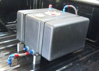

That fuel cell looks like an ordinary rotomolded "Jaz" tank (LINK ). It's actually pretty nice, but yes the plumbing could be updated. For instance, here's a random pic from the internet of modern plumbing on one of those tanks--

The spacer bolts were 12.9. And the broken one (long, 70mm) was already broken when I went to remove it - it was apparently glued in place with some flavor of Locktite (I hit it with heat before attempting easy-out removal of the stub, to be safe, but the others came out with just an Allen wrench and no heat). Assuming that the remaining 3 bolts have also been stressed, I'm replacing all 4 with a fresh set of grade 12.9 to be safe. And probably blue Locktite, as a backup.

The main center block on your steering modification looks like one we make on our CNC plasma cutter however the rest is not quite the same, so either we did it as a one off, or some one modified our part or some one copied our parts.

Thanks, Jay. I know Hannigan supposedly makes a similar spacer, perhaps others as well. Can't be too many ways to design such a thing, so maybe their design is similar because of similar purpose and BMW design constraints.
I've rebuilt the front fork sliders while things are apart... finding that the bottom bushings in the slider (not shown on any BMW part fiches) were chewed up much worse than the top bushes (both sets replaced, all the same part #). But that got me to thinking... with the spacer block in place, could the fork tubes now be a bit too short, and be pulling out (and back in) to the lower bush as the fork works? (I'll be measuring when I put it back together). For now, just trying to source a 2.75" longer braided brake line to safely accommodate the added spacer height, while working through the rest of the 12K service and other deferred maintenance.

The part in question is not from Hannigan. It appears to be homemade. I really do not see anything bad about it. Note that the LT does beg for spring rate up front when a sidecar is attached. If you look you may notice a non stock spring or a spr
ing spacer in there.
