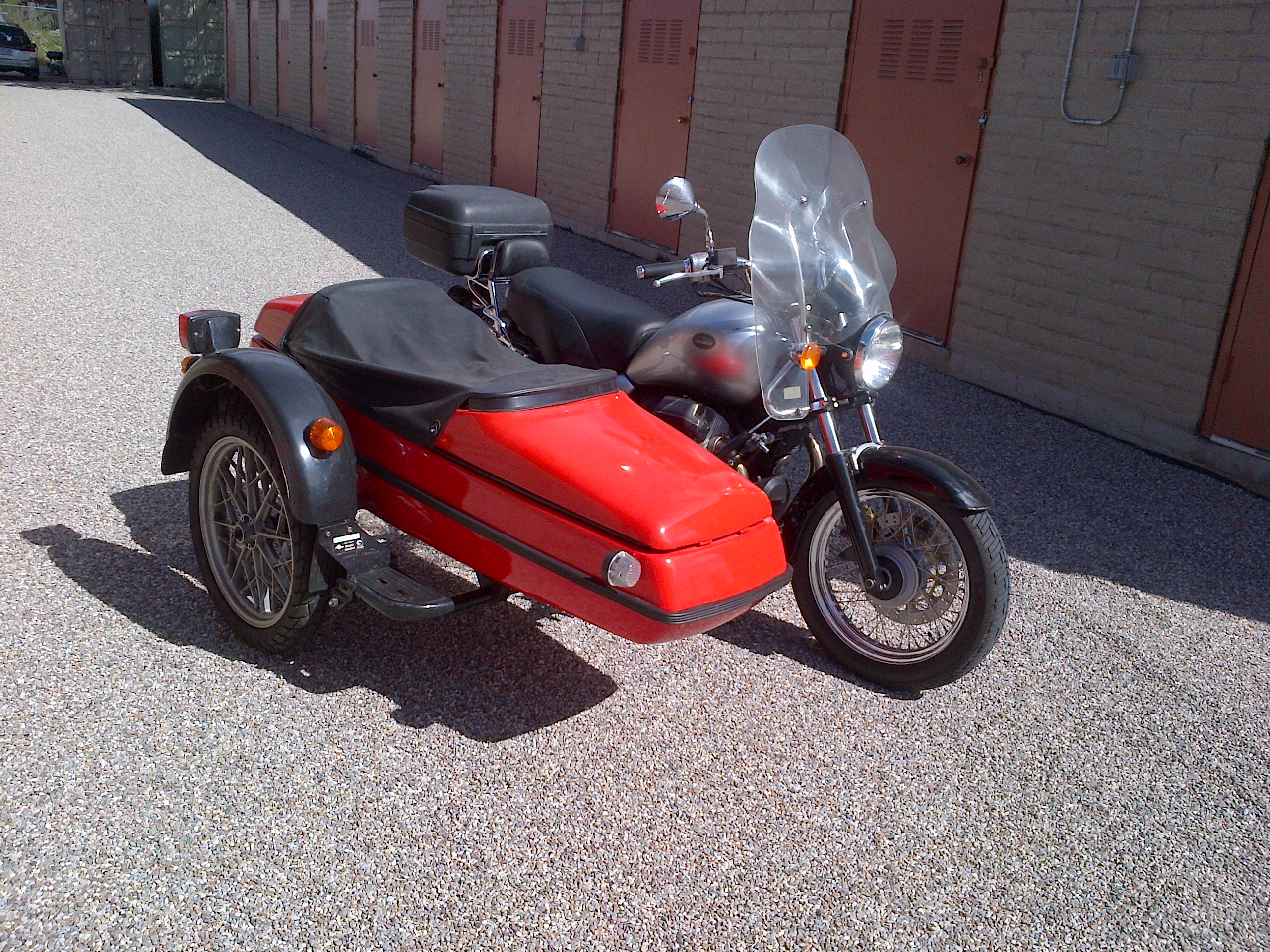

Fellow Sidecarists -
I have a 2003 MG Stone Touring with a Sputnik chair. The previous owner of the Sputnik changed the original wheel to a 70s BMW mag wheel because it had the same axle diameter. I would like to change it to a wheel matching the Stone but know that the Stone axles are a different size from the Sputnik. Would it be as simple as finding a different bearing that would fit the wheel and the axle? Has onyone done this type of thing before?
Thanks,
Rod

Most standard sized wheel/axle combos can be accomplished with bearing changes. The other critical measurement is axle length. If too short you have a problem, if too long spacers or washers will take up the extra space.
Posted : May 25, 2015 2:34 pm
Your axle on the Sputnik is 17mm, The stone 20mm, there is not a bearing swap that will make this change. So you will need to change the axle out on the Sputnik in order to do this.

Jay, from what I could find, the bearings on a Stone are 20 ID X 47 OD X14 W and the current BMW bearings are 17 ID X ? OD X12 W. From the wildguzzi.com board, I got a bearing #6303 that has the right dimensions (17 ID X 47 OD X1 4 W) but I haven't looked at axle length yet. Did you find axle length to be an issue when you did Sputnik wheel swaps? The snowflake wheel is pretty thin.

It is the O.D. that will not allow this to work, if there is a bearing that will work it is not a very common bearing or listed in any of the catalogs we use.
