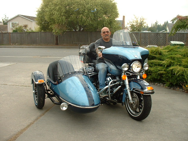

If it is a 16" spoked wheel it must be a Companion model. If so it will probably use a rear wheel (7" hub).
The mount set is the same as for the Friendship models.
Here's a Companion GT mounted to an Ultra.
