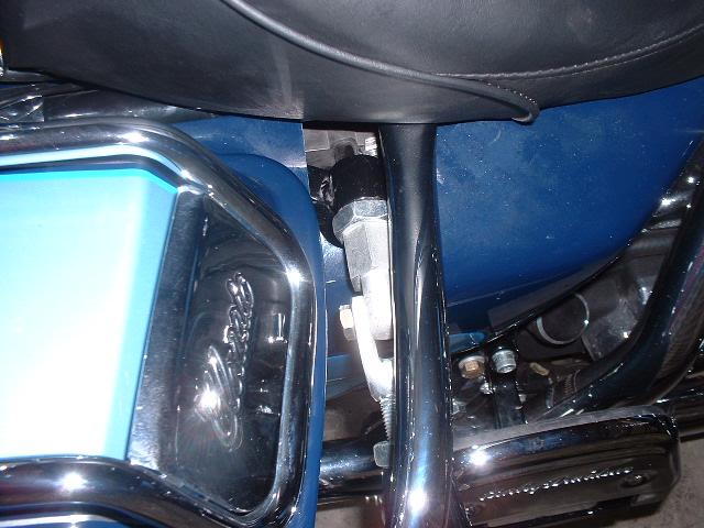

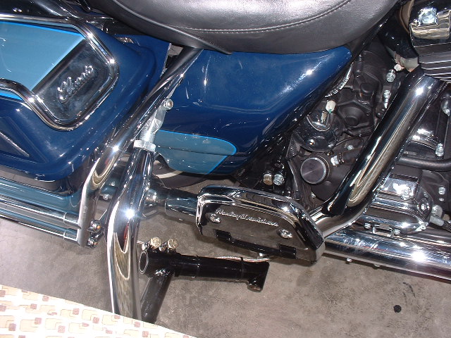

There is considerable difference between the FS III and a TLE as far as mounting. Harley uses 3 point mounts, CSC cars use 4 adjustable mounts.
I've had a Harley Dealer in Washington bring a CSC to me for mounting after their tech's spent up to 16 shop hours ($$$) on one and it still wasn't mounted.
(See Peace Officers Edition attached). Same mountings as the FS III.

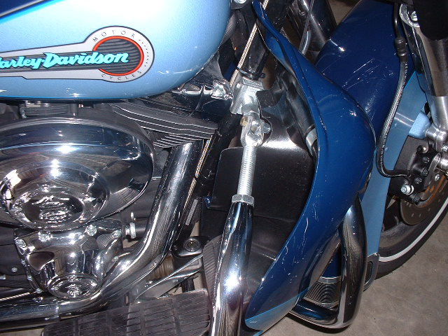

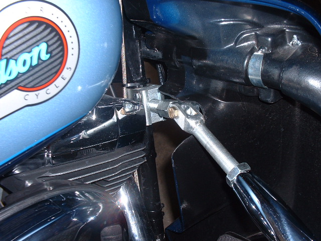

You'll need to mount the CSC sub-frame mount set first then go to the S/C instructions. Set the sidecar and bike side by side with the car level and the bike as level as possible. If the sidecar has electric tilt the screw should be in the center position. Connect the two lower Heim joints and set the initial toe-in. Start with a toe-in of about 1" measured at the bike axles (this can be adjusted easily after road testing the outfit). After the initial toe-in is set, load the bike with the expected road weight then give the bike about 1 degree of lean-out and connect the 2 upper struts. If using fairing lowers, you will have to relieve the right side one for upper strut clearance or remove it altogether.
At this point your sidecar is firmly mounted after you secure all the nuts and bolts. The rig is now drivable and the alignment can be fine tuned.
The lighting, electric lean and brake hookups can be left to a shop if you don't have a shop manual or are unsure of the correct places to tap into for connecting these items so they will function well without causing problems.

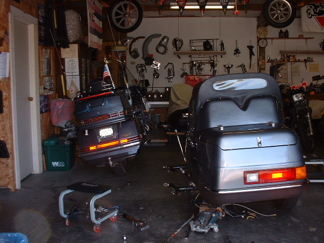

It's always easier to do the sidecar mounting with the body off the frame.
Much easier to access the attachment points. Fine tuning should be done later with a complete and road weighted rig.
A hitch that pulls from the inside sidecar frame rail is desirable since the combined outfit will take up less lane space. This is especially true of a double wide combo that can easily run off the pavement in some tight narrow mountain road turns.
State and National Park roads and many Scenic Byways are good examples of roads that are not up to USDOT standards in lane width and turn radii.
The attached GL/FS III outfit had a bike mounted hitch and was pulling a trailer when it went off the road in the mountains due to excess width.
Luckily no injuries were incurred but it took quite a bit of time and $$$ to get it back on the road again.
