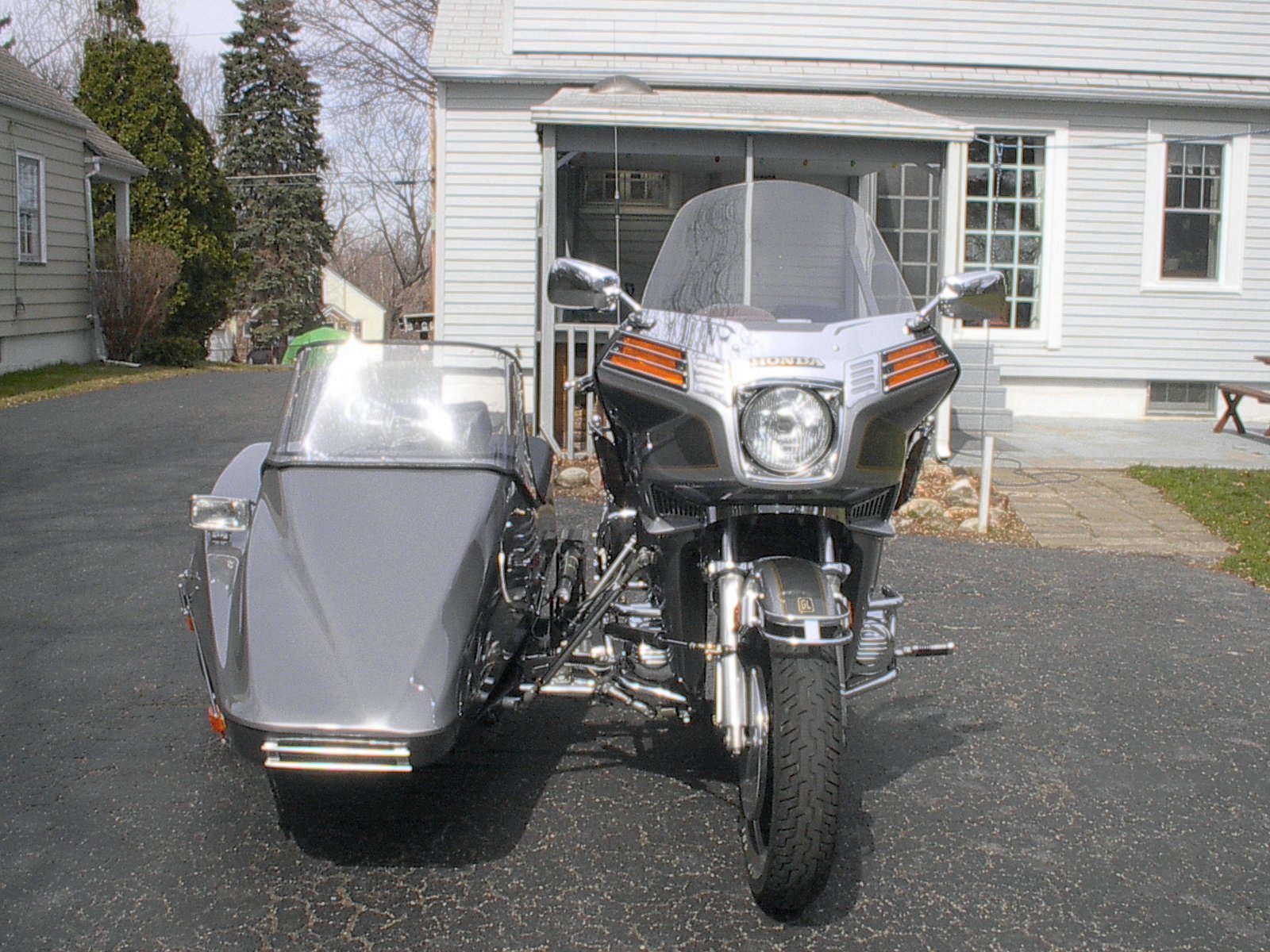

oldriders that is a nice looking rig
sfchock what year is your wing, looks like an 1100

(@sfchock)
Posts: 35
1982 GL1100A. I have had it since 98 and put the Formula II on it in 09 or so. Works well for me, Loaded I have to downshift for longer hills but for the most part travels well. Gas mileage is about 30.
By the way mine was installed on a 1500 prior to my ownership.
