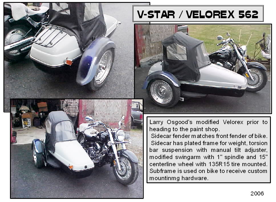

My camera is wacked out right now or i could post some pictures. We place the new spindle on an expended swingarm. The shock can go on that also. If you have a shock that is too long the swingarm can be modified to place the lower shock mount onto the end of the new part of the swingarm or even below it with brackets.
Note that if you are getting into the fabrication of this anyhwo you may want to check to see if the swingarm tower is perpendicular to the sidecar frame. Many of the Velorex sidecars are not. You can slice through the swingarm tower on whichever side is required (usually the inside ) and bend it over then weld it , grind it and place a plate over the joint.
We also run a piece of flat stock up the front of the swingarm tower to cover the seam.
If you want to add additional stength to the sidecar frame itself covering it will 1/8" steel plate will do a good job and add about 30 pounds which is not a bad thing.
