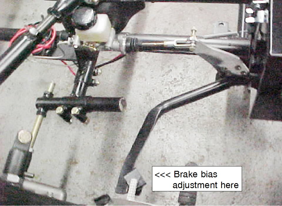

It is not that uncommon although some do it different ways. See attached for a hydraulic setup where the sidecar has it's own master cylinder.

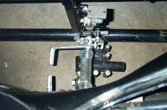

Attached is a link to a pic of a seperate brake pedal setup on Bill Strong's rig
