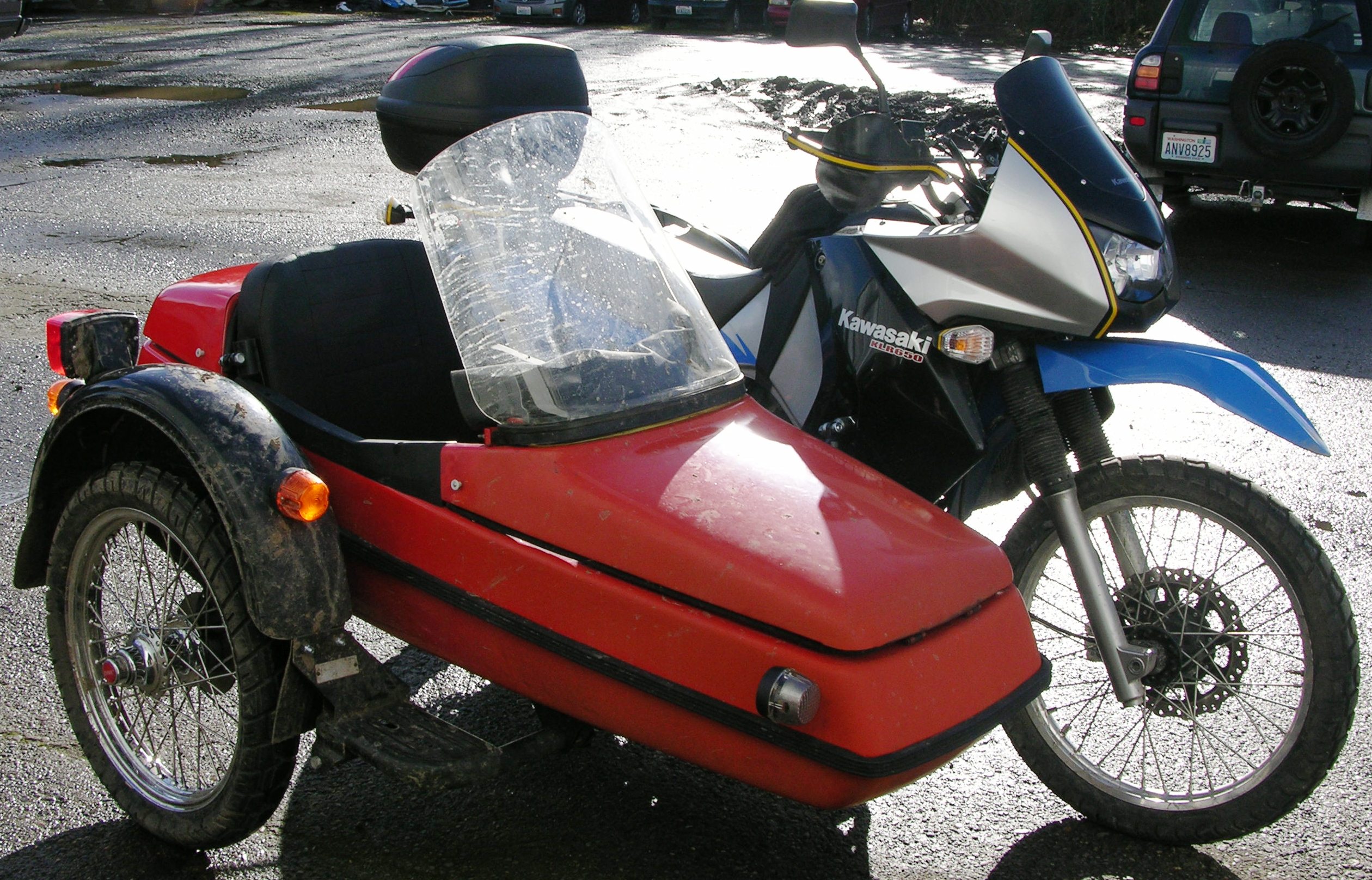

Yes, we do make mounts for the KLR, I also own and ride a KLR with one of our Sputnik sidecars. We build a leading link front end and offer a stiffer spring for the rear of the bike. We are in the Seattle area, many people stop by on their way to Alaska. I have attached a photo of my current KLR, I have owned many as people keep buying them from me.
Jay - Nice looking rig. Could you please send me some pictures and pricing for your KLR mounts and rear spring? Please send to fthoffman@yahoo.com

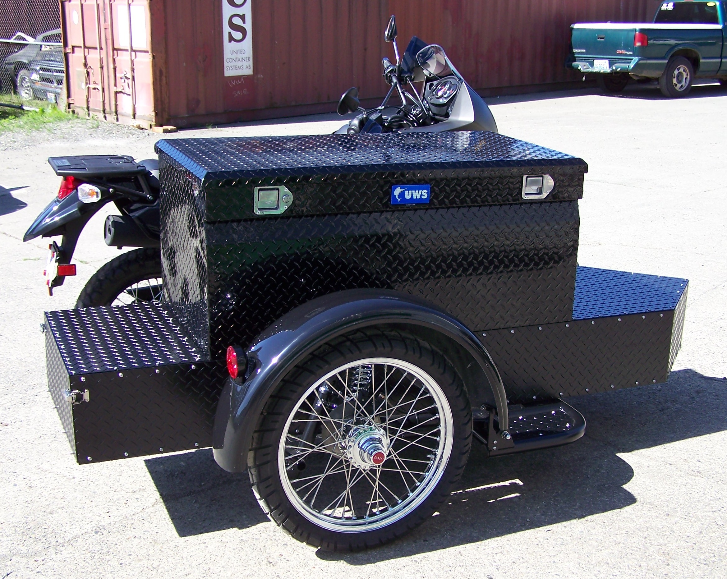

Attached are some photo's of a KLR cargo sidecar we custom built for some one from Australia to carry surf boards and documentary film equipment on a trip the length of the America's. If any one see's it, it was stolen some where in Mexico.
Very, Very Nice!....and looks very, very heavy too.
