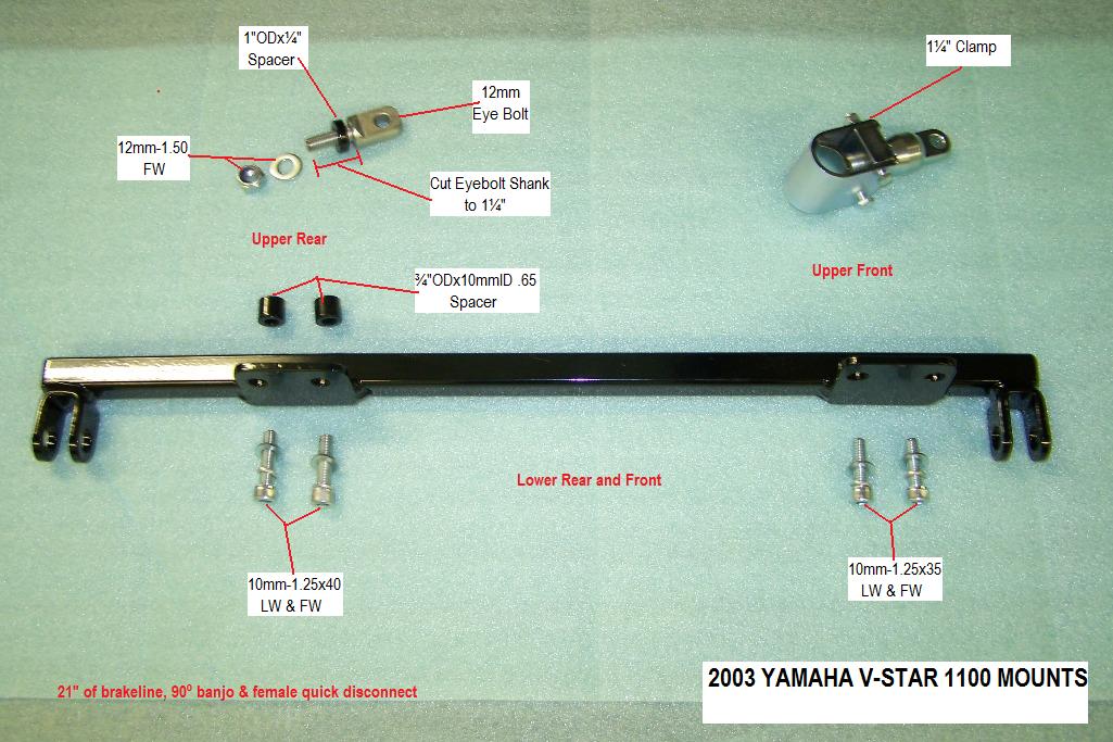

Hi everyone, can anyone tell me where is best to install sidecar mounts on a 2000 Yamaha V Star 1100 I am looking at it and I am not sure where to install the rear upper arm bracket on the bike without it being in the way of the rear foot peg.
Can anyone send me some picture of how and where you installed it ?

I can not recommend a Velorex on a bike as large and heavy as your bike, The Velorex really was designed for much smaller bikes. While we do make a mounting kit for your bike we will not sell it for this application. Should you go with a stronger sidecar we will be glad to help. I have attached a photo of what our mounts look like.

What about if I beef it up with some weight and a heavy duty suspension ? I see lots of 1100 cc on the net with Velorex 562 is that what they did ?
I am new to sidecars and want to do it right, but on the other hand, the guy I bought it from, had it on a Harley Fat Boy for several years and it seems that it worked just fine. so I am kinda puzzled !
