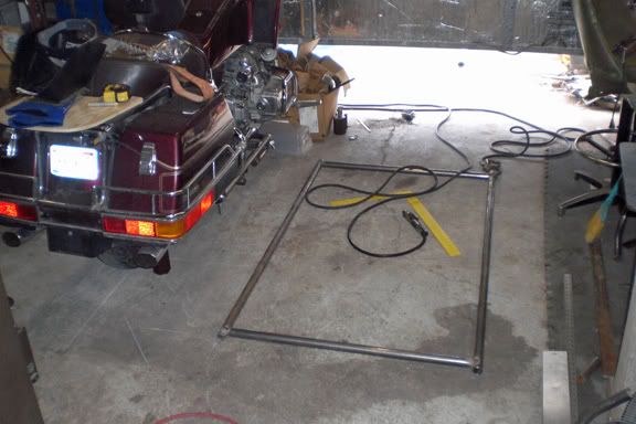

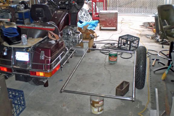

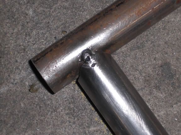

Finally got some work done today. It seems like every time I turn around something comes up. Anyway, Here are some more pictures:o)
Here I have the frame tacked together. I tacked one side, checked it for square and out of rack, then tacked the other side.
Photobucket
Here is a quick closeup:o)
Photobucket
Playing around with the height. I think paint cans are perfect!
Photobucket

I wonder if that frame tubing is going to be strong enough. I don't mean to be critical but there's a lot of stress and strain on the axle to frame joint.......

Originally written by gnm109 on 4/6/2009 12:43 PM
I still have a couple tubes and a few gussets to add to the mix. I'm drawing the gussets up today. I'm going to have them cut out on the plasma cutter at work:o)
Thanks, wes
Posted : April 7, 2009 8:47 am
