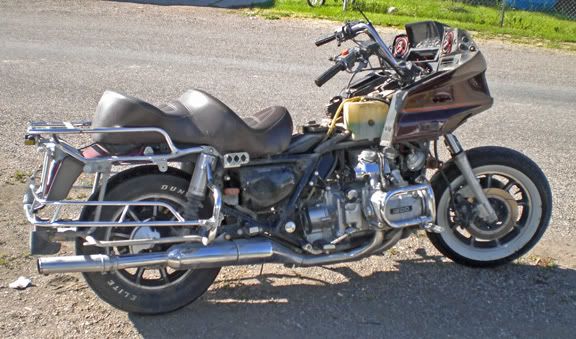

Hey, Thanks for that link. My Stator is working fine now. But I think this winter my rig will get a upgrade. I was going to add it to the sidecar wheel, But I think I am going to add it to the bike. The car might get reverse? I'll have to see.
Wes

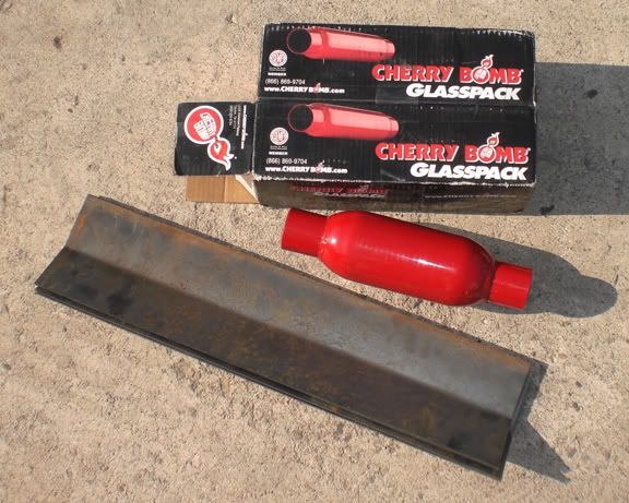

Some more parts showed up today o/ This is probably wrong on several levels, but I'm going to make a new exhaust for my wing. A bike should sound like a bike.
Photobucket
Hopefully this works:o)

Originally written by Wngnut on 6/27/2009 6:24 PM
I owned a 1994 Goldwing 1500 for close to 5 years and put abut 50,000 miles on it. I have to say, what I liked the most about that bike was the absolute silence of its exhaust system. I'm not being critical here but you learn to appreciate quiet mufflers on a long trip.
The other thing one needs to be nindful of is any affect on the fuel air ratio and overall performance. My 2004 Harley Ultra runs beautifully with its stock engine and mufflers. I haven't even done the much-touted factory computer tuning download ($195.00!!!!, no thanks). If I were to change mufflers, it would cause the EFI system to run lean and could damage the engine. So typically, it's necessary for Harley owners at least to start changing the fuel mixture with electronic add-on devices such as the Harley Screamin' Eagle Race Tuner (SERT) or similar units. It gets exoensive.
It's getting even more interesting here in California now. I understand but haven't yet verified that a bill was recently passed to do motorcycle smog testing. That makes me very happy indeed that I haven't changed cam, mufflers, and all of the other things that are usually done. I probably have one fo the few stock motorcycles in California! If that makes me a Geezer, I'll happily accept the title.
(I wonder how they will do a test on motorcycles with sidecars if they have to put them on a dyno like they do with cars. I'm not taking the sidecar off just for a smog test. )
That said, the main reason I haven't done anything to the bike is that it's got almost perfect torque for a sidecar unit. The engine starts pulling niicely from 1,500 rpm and then cruises smoothly at 3,000 so I'm happy with what I have. When underway, I never run below 2,000 rpm and it's all good at that range or higher so as to avoid lugging. As you probably know, changes that provide greater performance generally raise the useful torque level to higher rpms, which is something I don't need.
The other issue is whether your passenger can stand a loud pipe on a trip. It can get tiresome after a while.
I'm not trying to rain on your parade - just giving you some of the reasons why I don't make too many changes to my bike.
I repeat, though, the work you've done on your sidecar is really amazing. I too love to work in metal but after seeing what you've had to do to build a sidecar, I'm glad mine came in a crate! LOL.
Keep up the good work. This is as fine a piece of technical writing and illustration as I've seen anywhere.
