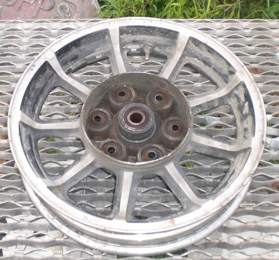

I have a little work on the bike I want to do. The back wheel is going to be replaced. When I first bought the bike the wheel was wallered out where the bearing goes. I bored it out and inserted a sleeve. I bought a replacement wheel and I'm going to powder coat it and install the new car tire (if it ever gets here) I was a little worried about the side load that might be applied to the wheel.

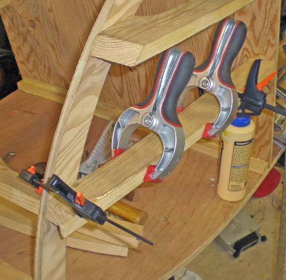

Working on the body todayo/ The wood in the back doesn't line up very good from top to bottom? I cut the middle piece to narrow. So to fix it I have to add some then sand it down a bit. Here is a quick picture.
Photobucket
I'm also cleaning up my new wheel.
Photobucket
