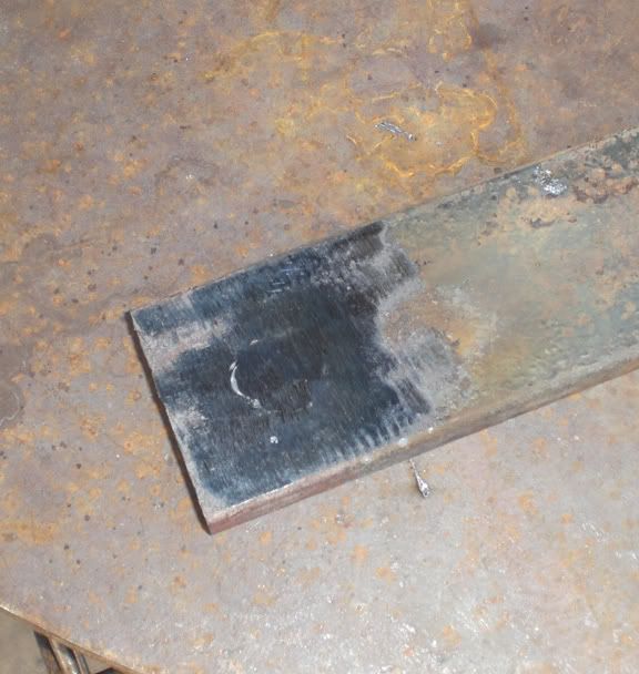

The bracket that mounts to the car was cut out and drilled. My stupid Tape measure lied to me (can you believe that?) and the holes were about 3/8" off:o( I turned up the amps on my TIG welder and plugged the hole and re drilled it.
Not bad. I used some 7018 stick with the flux knocked off for filler rod:o)then just ground it off flush.

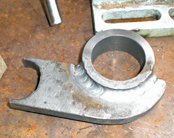

There sure are a lot of parts on a sidecar. A lot of grinding and welding, to. I have half of the mounts made for the front pivot. I need to take a break and get a couple of 1/2" bolts.
Photobucket
Photobucket

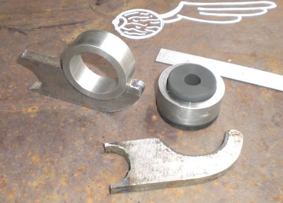

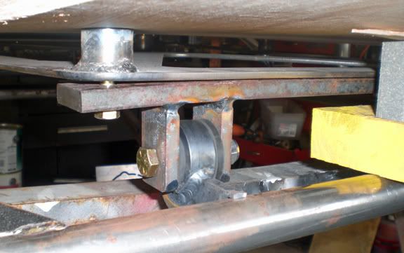

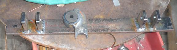

I got that bracket all welded up.
Photobucket
It warped a little. But here is a shot from under the car in the front. You can see the pieces that hold the rubber. They will be welded to the frame.
Photobucket

Wes,
I see you're learning of the effects of heat distortion and the pulling strength and distortion of a weldment that hasn't been stress relieved.
Your Arc Welding Procedure Handbook covers this phenomenon.
Posted : June 10, 2009 5:36 am

That warpage is easily corrected.

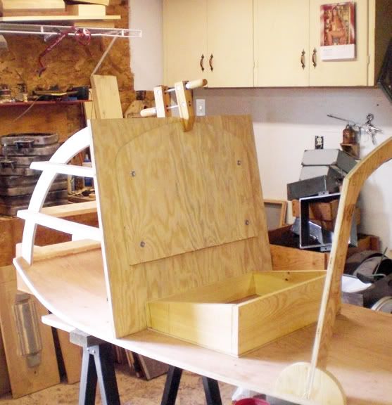

Its been a long few days here. I've been putting in 11 hour days at work and still trying to squeeze some time in on the sidecar. Tonight I got the back of the seat ready for the upholsterer. I made a box for the seat to sit on. The seat will be the lid. This will give a little extra storage. The lid/seat will be the main focus tomorrow. Then some body pieces need fixed. I'll post some pictures when I get off work tomorrow:o(

Here is what I have so far for the seat. I used some of those nuts that press into wood to hold the seat back to the car. I'll paint the wood then it will be ready to be covered.
Photobucket

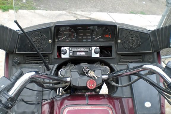

This pertains to the car a bit. Here is what the dash of my wing looks like now.
Photobucket

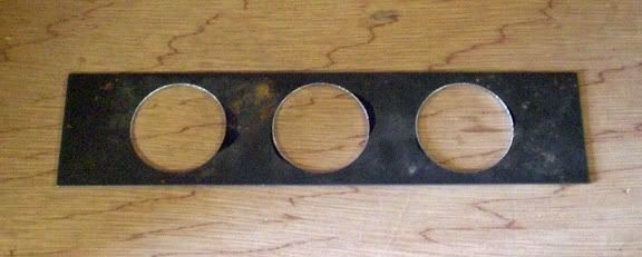

I plan on adding 2 volt gauges and a clock to the bike. There will be a spare battery on the sidecar. I made this to hold the gauges.
Photobucket

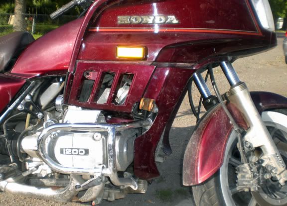

The painter at work said he would paint my Wing for $150. It sounded like a great deal to me. This guy does some pretty nice stuff. I started pulling off the plastic. I have everything accept the main fairing off. I think I'll have it painted on the bike. Those Goldwings sure don't look like much with there plastic off. Should be painted this weekend:o)
Wes
