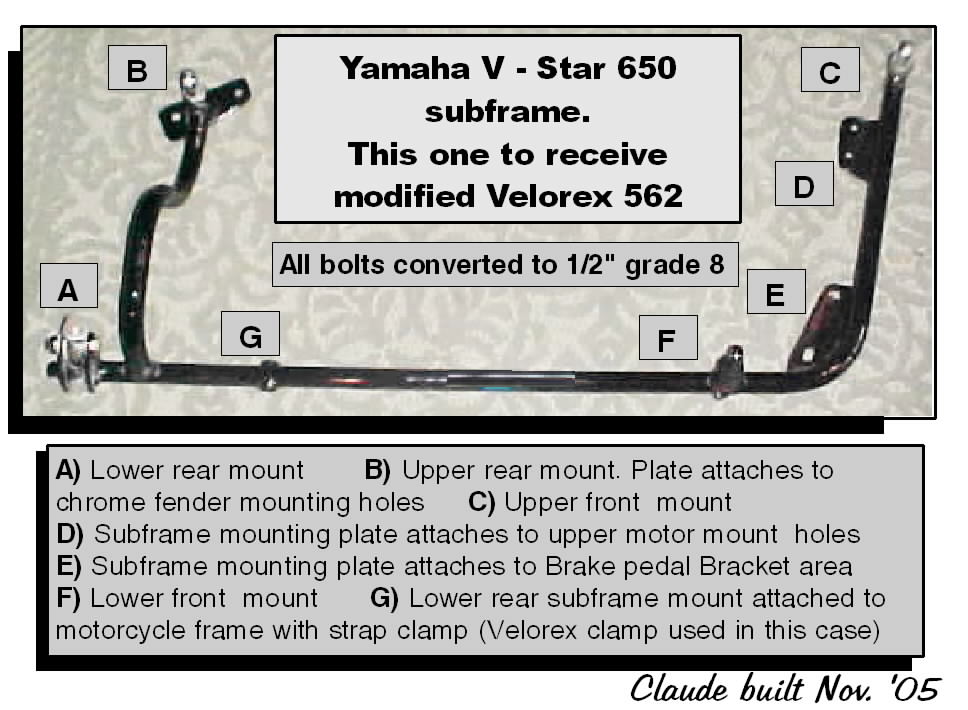

Attached are pics of a subframe we did back a while. It was for a modified 562 .also pictured.

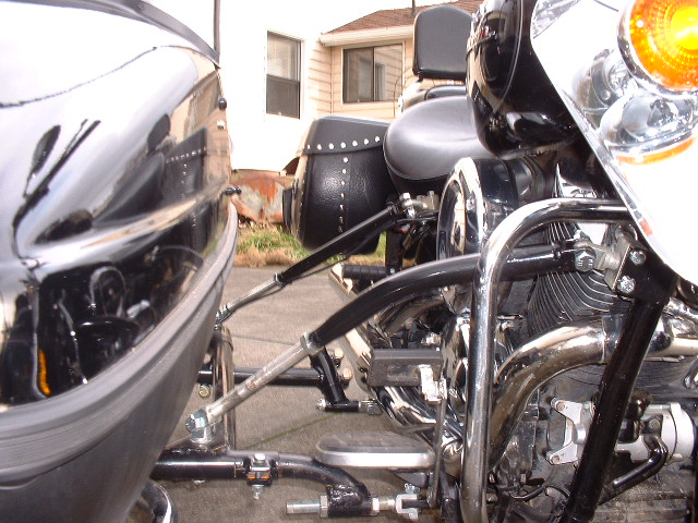

Here's one of ours. As I recall we used a curved upper strut to get brake pedal clearance. Like on this VStar 1100 with forward controls.

After looking at Lonnie's pictures I think a top bar like you have would do the trick. I think if I go with the lower rear mount flipped upside down it will work (I hope) but there is no way the front upper bar will work as is.

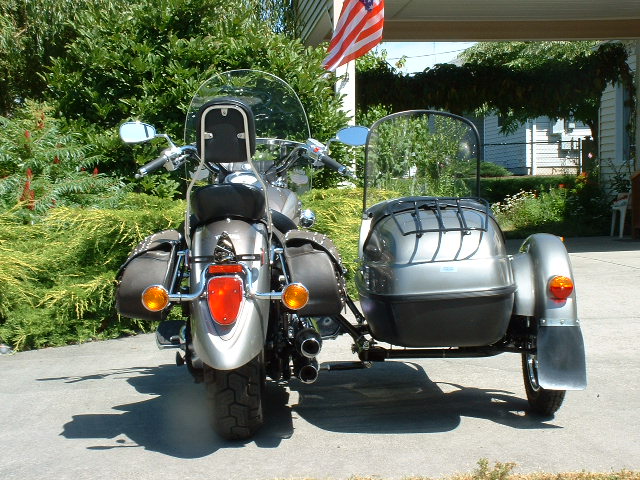

Here's a lower rear strut position that clears everything.
On this one I spot welded the clamp strap to prevent slipping .
