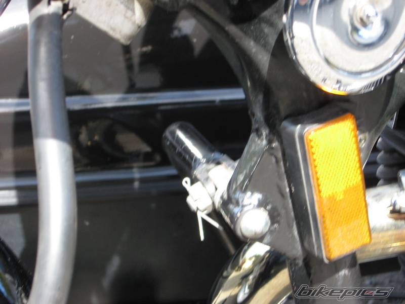

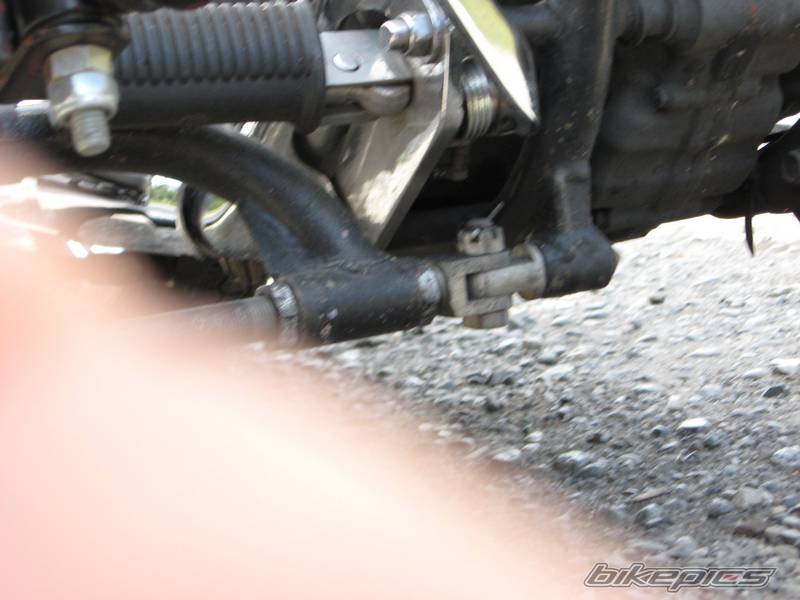

That's why I don't use clamped mounts. These are the front mounts on a Suzuki S-40.
Posted : April 17, 2014 5:56 pm
