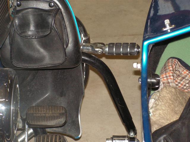

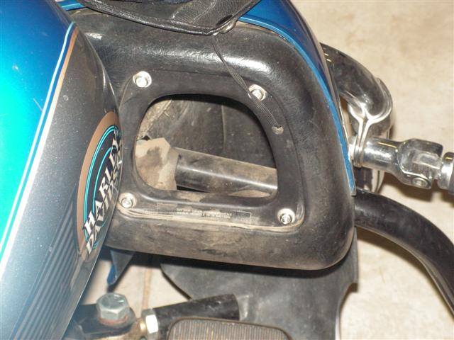

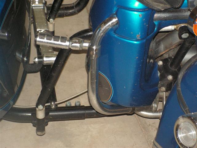

I had a set of fairing lowers on my FLHT, but I had to remove them when I installed the TLE sidecar. I don't mind riding without them during the warmer weather, but with winter approuching. I want to put them back on. I know with the sidecar mounts, I can't put the right side fairing lower on without modifing it first. Are there any problems doing this, or should I just order a new one made for use with a sidecar?

been there, tried that, it was a expensive total waste of time made a perfectly good part into landfill fodder... the proper one goes on from the FRONT of the crash bar after the sidecar is installed & have a joint just below the bar - the whole top is a seperate part - the non sidecar parts go on from the BACK.. & just have a small cover over the bolts.
- you are best off on getting the proper parts.
they show on ebay fairly regular or a GOOD parts man at the dealer can get you the parts & all the itty bitty bolts and clips needed. they will paint match to any stock color.

I don't know how the TLE mounts but the Liberty took only a slight bit of modification to the lower and it works fine. Lost the use of that fairing pocket but that's no big deal at all.

This has come up before. The Ultra sidecar lower comes in the crate with a new Ultra sidecar. I've mentioned before that I've not been able to find a part number for it since it's a part of the connection kit. 87166-99B is the last part number I've seen for the entire kit. I'm sure that number has been changed now that the 96" bikes have come out with a new frame. It's probably 87166-99C now for the whole kit.
I got my Ultra sidecar lower from eBay. Mine was new and unpainted. You will find them on eBay periodically.
The Liberty setup is totally different from the standard HD TLE/TLE Ultra connections. The stock lower can't be modified to fit on the TLE sidecar because of the shape of the front bow and the presence of the steering damper.
As TIMO482 says, don't try it or you will have some high priced scrap on your hands.

I got the alternate lower when I bought my hack, but I don't like them. I know my FLHRCI runs hotter dragging the tub around....and the lower that came with the sidecar is un-vented. I have a pair of nylon "Elephant Ears" I snap on when it gets cold...I love them!
