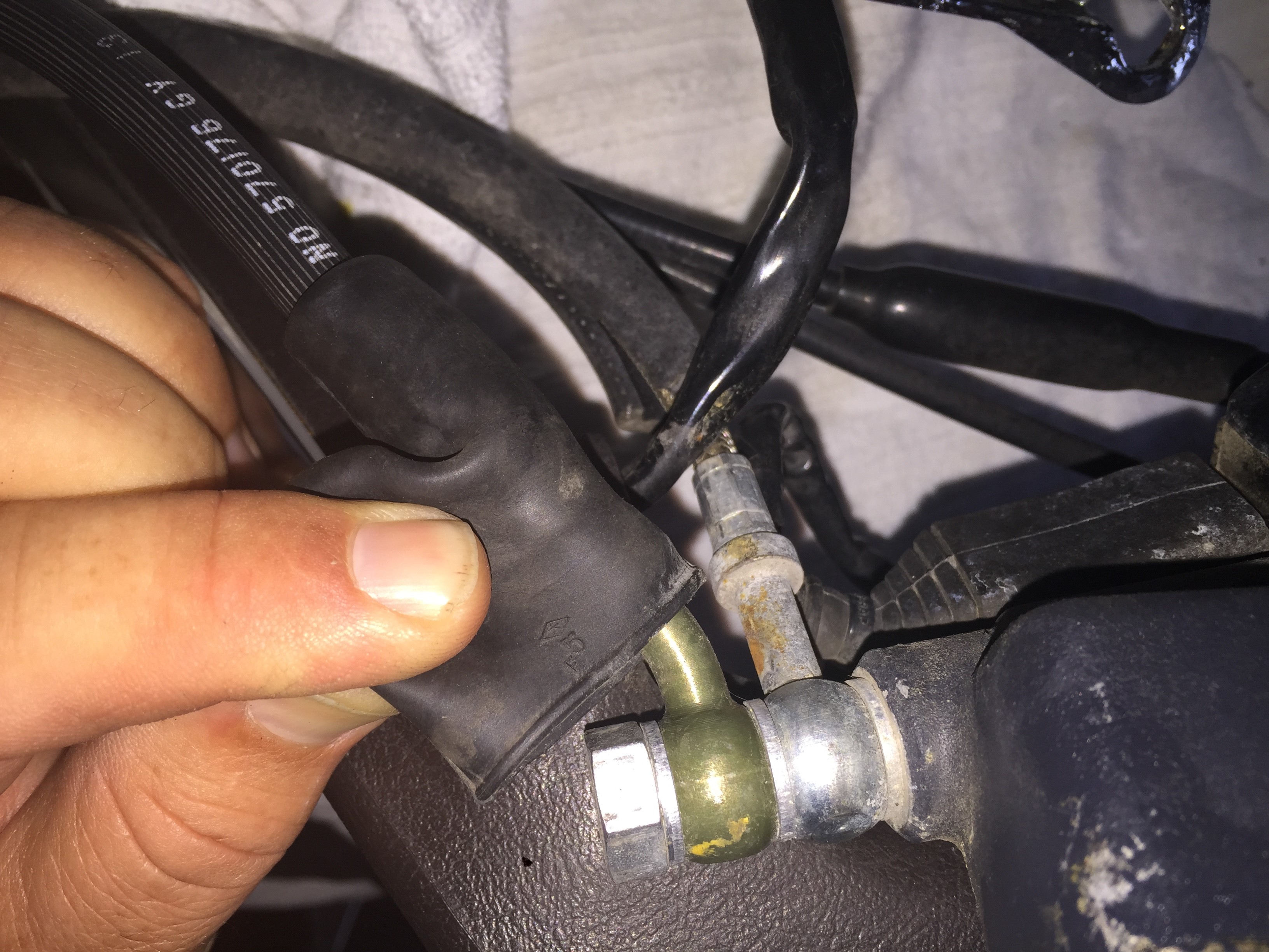

Hi Jay / All,
I am a new proud owner of a GL1500 with a CSC FS III hack. Really enjoy the ride - really DON'T enjoy all the fun maintenance items I am finding out about... 🙁
Question about the conversion from GL1500 to GL1800 front brake master cylinder. My front brake is the original, and was disconnected from the sidecar disc brake. I see now why...
If I upgrade the GL1800 brake - I see the different angle (and you mentioned it below). Do you happen to remember if the banjo bolts need to be changed out? Or are the threads the same? Or do I NEED to purchase some angle bolt?
Mine was put together with a longer banjo bolt(?) and the connections back-to-back. I guess that is how they were done back then? I am going to attached a picture here for you to see. Would love any advice about switching to the GL1800 front brake...
Thanks in advance!
-Mark

The bolts are the same, we just twist the hose to line it up.
