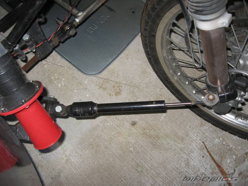

After making sure the sidecar is correctly toed in and the bike properly leaned out, one of these will keep it safe from head shake at any speed.
On my rigs I can let go the bars at any speed without head shake. It is a steering damper from an old style VW beetle.
It uses a universal of my own making at the rear and a heim joint at the fork to allow for angle of steer and up and down of the forks.

That is what I was going to ask do you have a steering damper. Even the Harley damper is a VW one. Here is mine on my 02 Ultra with a 06 HD sidecar.
Posted : March 17, 2013 2:56 pm

No I don't have a damper but will get one. I like the idea that you have it hooked up under the triple tree and not bolted to the front fork. Great Idea thanks

The one on my bike is stock for a HD sidecar.
