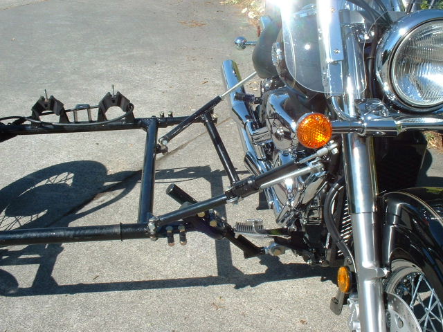

A steering damper from an early Volkswagen Beetle is often used when wobble can't be controlled any other way.
Brackets are usually fabricated connecting it to the sidecar frame or struts and (preferrably) to an upper point of the steering on the bike. On tubular front ends, if connected as low as on the lower sliders (which move up and down) the damper should be mounted as near as possible to 90 degrees perpendicular to the fork tubes to prevent "bump steering".
This is a phenomenon where hitting a bump will cause the steering to jerk one way or the other as the front suspension goes up or down.
Here's one mounted on a Suzuki/Dnepr rig.
